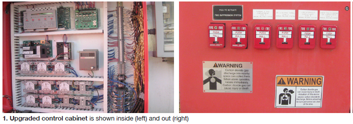

Improved, expanded GT fire protection system
Challenge. When the gas turbine/generators were designed in 2002, the OEM provided rationale for excluding fire protection for the collector cabinet and load tunnel. Over the last 13 years, though, various insurance carriers have sited this design as inadequate and requested that fire protection be added to these compartments to minimize possible damage in the event of a fire.
Solution. A few options were considered by the plant staff before the decision was made to install high-pressure (HP) CO2 systems which would work in conjunction with the original low-pressure CO2 system. The installation of this equipment required an upgrade of the existing control panel to provide ample capacity for additional detection, notification, and control modules.
The original fire-protection configuration separated the turbine equipment into four zones:
  • GT/gas compartment.
  • 2 bearing area.
  • Accessory module.
  • Liquid fuel/atomizing air.
The upgraded CO2 control cabinet (Fig 1) accommodated addition of two new zones to protect these areas (Fig 2):
  • Load tunnel.
  • Collector cabinet.
Using NFPA 12 for guidance, HP CO2 systems were designed and installed. Additionally, several more changes were made:
  • Relays were added to provide automatic shutdown and Mark VI control logic was modified to signal the operator.
  • The generator automatic-hydrogen-dump logic was connected to the system to provide additional safety margin.
  • Two sensors were installed to initiate evacuation of the hydrogen charge.
  • CO2 concentration tests were performed to validate effectiveness of the system design parameters (in accordance with NFPA 12).
  • Dampers were installed to effectively isolate air flow.
Results. The load-tunnel compartment was tested to 84% concentration, and required only minimal adjustments to the doors in order to completely seal the compartment.
The collector cabinet doors and soft-patch gaskets required more attention, and the excitation lead box required sealing to reach the required concentration.
