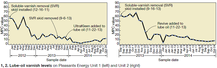

Pleasants Energy LLC, a subsidiary of GDF Suez Energy North America, operates two simple-cycle 7FA turbines in St. Marys, WVa, commissioned in 2002. As peaking units, their run time is low, but their combined lube/hydraulic system is in continuous operation with the units on turning gear, said Gerald Gatti, plant manager.
During the past few years they experienced increased varnish issues in the lube oil. “Varnish is accumulating in the system and building up, typically on some small servo filters, similar to where other gas-turbine users have experienced problems with varnish,” he said. “Although we did not have any plant trips due to varnish, we did experience failed starts several times. I’m sure if the plant was running a lot more, we would ultimately also have plant trips caused by the varnish buildup in the system.”
Gatti arrived at the plant in 2012, and one of his first jobs was to find a solution to the varnish problem. The plant had purchased a varnish removal skid and initially installed it on Unit 1 because the lube oil in that unit had higher varnish levels than Unit 2. The varnish level dropped quickly but then trended up again, “because the original filter canisters had expired. They get saturated pretty quickly when you have that much varnish in the oil,” Gatti said.
The operators went through several sets of filters at a cost of about $4000 each. “After one year, the varnish level in the fluid had been reduced to acceptable levels, but the SVR didn’t remove the varnish that was already plated out within the system or reduce varnish formation,” Gatti said. The plant still had servo filters clogging with varnish throughout the system.

While weighing his options, Gatti conducted an experiment. In November 2013, he put 660 gal (10%) of UltraKlean in Unit 1, with the intention to run it for 90 days, then dumped it and recharged the system with TF-25 (Fig 1). At the same time he moved the SVR skid to Unit 2 and put in 10% Revive (660 gal) to work together with the skid (Fig 2). After 90 days, lab analysis reported that results were good for both systems.
“The UltraKlean actually worked similarly to the Revive, even though the difference between the two is special additive packages that they put in the Revive for long-term use,” Gatti said. Both modifiers dissolved the varnish that had been plated out and kept it in solution. “That’s the big benefit,” Gatti stressed: keeping the varnish in solution. Revive is twice the price of UltraKlean because of its formulation. Gatti has been running both the Revive and the UltraKlean for more than a year now with good results.

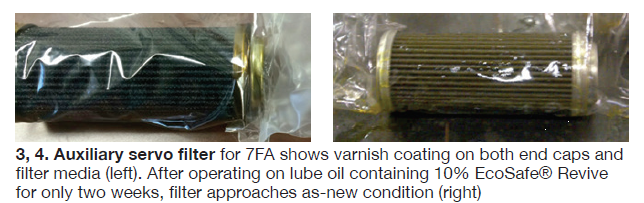

Having used both the side-stream filter and the PAG, Gatti says the skid “certainly removed the varnish from the fluid. But it didn’t dissolve the varnish that’s already been plated out in the system,” he said. “We continued to see small pencil filters that were plugging up with the varnish.
Since we put the UltraKlean and the Revive in, those filters have been spotless. We were changing out these little servos every six months, whether we ran the plant or didn’t run the plant, because they were caking up with the varnish. The filtering skid is a good way to prevent varnish from building up, but once you have it built up, it’s difficult for the skid to clean it.”

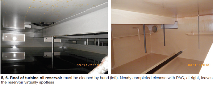

Users may take several different approaches to the change-over. After running the Revive system cleanse, NV Energy drained the system, with special attention to all the low points in the system, before refilling with TF-25. The reservoir was “virtually spotless except for the roof,” which the TF-25 had not touched, Crisp said (Figs 5, 6). “It really cleaned up the bathtub rings that you typically see in your reservoirs (Fig 7).”
