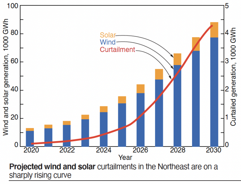

While solar power purchase agreements have reached 1 cent/kWh, solar and wind curtailments are rising, notes, Bradshaw, because of the mismatch between renewable energy daily and seasonal availability and electricity demand curves (figure). If you can use this excess electricity to moderate natural gas’ carbon footprint, then the phrase “renewable gas” isn’t quite as squishy.
One example is adding H2 to biogas which “sweetens” the methane content by up to 70% by converting CO2 to methane. There’s a net benefit here for biogas that would have been released to the atmosphere because methane’s climate impact is, using the average of the range of figures reported, around 20-fold greater than CO2.
