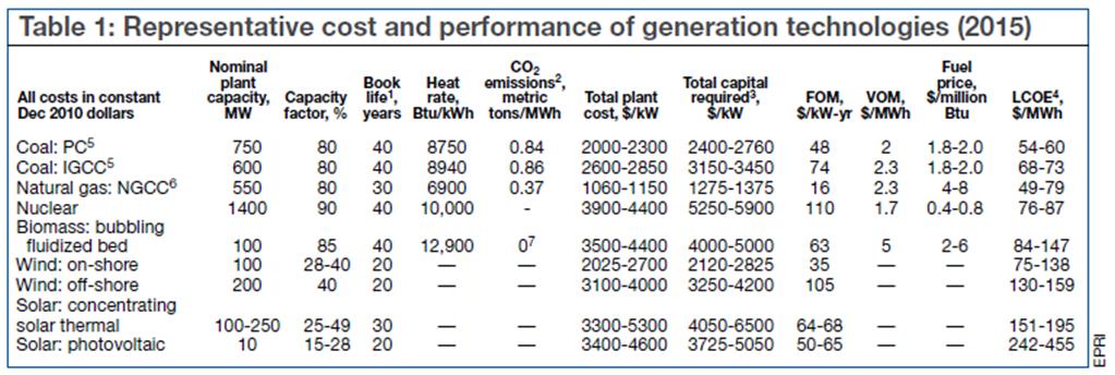

The challenge for wind, or any other option, to compete against gas is starkly revealed in Tables 1 and 2, which show EPRI’s forecasts for the levelized cost of electricity (LCOE) for several generation alternatives. Carbon cap and trade, or other national carbon policy or tax, is off the table politically for a while. And it’s a pretty sure bet that no off-shore wind turbines will be operating, since none have yet to be permitted.
Therefore, the relevant comparison is a gas-fired combined cycle without carbon capture against on-shore wind. The top of the gas option’s LCOE range is the bottom of the wind energy option LCOE. When you consider that on-shore wind, under the best conditions, is capable of a capacity factor only half that of a gas-fired plant, the overall cost of ownership is actually quite worse.
