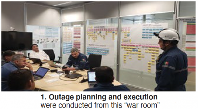

Solution. Goal was to control the pain points to reduce the time of scheduled outages and optimize resources, thus ensuring the integrity of people and equipment. The methodology selected was “Lean,” which focuses on quality assurance, time reduction, resource optimization, and effective communication. The implementation of this methodology was led by the engineering department with support from the O&M department and an external consultant. The rigor applied to outage planning and execution is evident from the details on view in Fig 1.

A visual scaffolding installation plan was implemented and strategic scaffolds were assembled prior to turbine disassembly.
An installation plan was implemented for electrical panels, etc. Previously, the equipment was installed and tested.
Scaffolding was designed and installed to allow work in tandem in the disassembly of turbine elements and combustion chambers.
A lifting plan was implemented to disassemble the entire roof, previously disassembled in sections. Plus, pre-location of mechanical lifting elements for easy availability.
A plan for disassembly and reinstallation of turbine instrumentation and wiring was implemented.
The schedule developed had no tolerance for the release of work permits in a critical route. A paramedic was added to the outage crew. Safety talks for personnel and contractors were held daily.
Execution staff was reorganized to assign a higher percentage of personnel to the activities on the outage critical path. The most experienced personnel were assigned to coordinate and supervise critical-path activities.
Perhaps most important was that there were no disabling accidents during the HGP outages. Plus, the execution time of the second and third HGPs was reduced by 15% compared to the first outage, which lasted 19 days. Quality standards were maintained and there were no problems during and after the outages. Finally, GE recognized the outage team as the best in Latin America based on the results of the second and third HGPs.

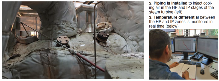

Working together, plant and OEM personnel determined that dry-air cooling was the optimal method. It maintained turbine integrity, did not adversely impact the cyclic life of the rotor and housings, and did not affect the housings or the critical path of the outage.
The method consists of injecting a regulated amount of air gradually into the HP and IP stages of the turbine while assuring that the temperature differentials between the stages were not so great as to stress the rotor.
Pesqueria’s operations department coordinated preparations with GE. Together they implemented the mechanical arrangements for the air supply (Fig 2) and conducted real-time monitoring of the temperature differential between the HP and IP zones (Fig 3). Goal was to cool the unit to the point where the turning gear could be shut down.
Results. The plan developed was successful, allowing cooling of the steam turbine while generating more than 400 MW during the outage without incident. About 30 hours of turbine operation were gained using this procedure in place of the previous (standard) method.
