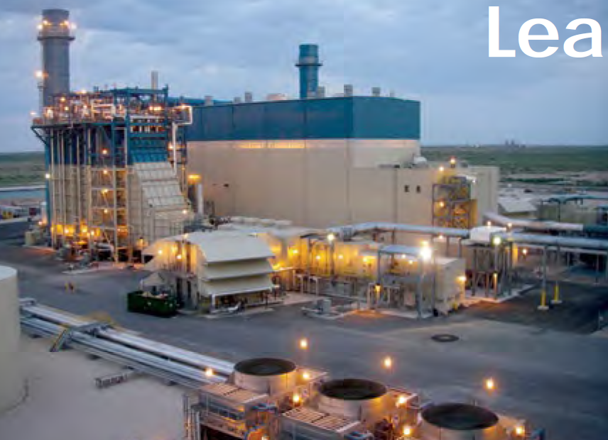

604-MW, gas-fired, 2 × 1 combined cycle located in Hobbs, NM
