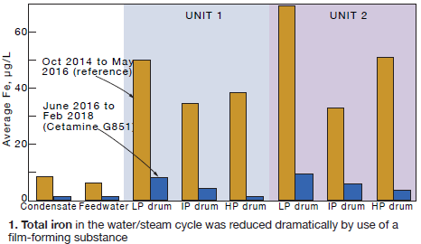

During the first half of 2016, TSP was added to the HP drums, but this practice was conducive to severe hideout and discontinued. In mid-2016, Cetamine G851 (oleyl propylenediamine, or OLDA) was added to feedwater at 1.0 to 1.5 mg/l (ppm).
The presenter reviewed monthly data for pH, phosphate, degassed acid conductivity, total iron, and carryover. Total iron in condensate showed a significant drop, as did total iron in LP and IP drums and in average values for both HRSGs (Fig 1).
Additionally, water/steam chemistry analysis showed a further reduction in iron during Cetamine G851 treatment in 2017 and 2018 (Fig 2). Carryover dropped significantly in 2017.

  • The plant saw a marked reduction in iron levels, especially after off-load periods. Typical levels now are less than 5 ppb during normal and two-shift operation, and below 20 ppb four hours after a post-maintenance restart.
