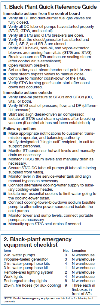

  • The exhaustive black-plant procedure previously developed by plant staff provided little value to the technicians who responded to the sudden challenge. A concise, readily available “Black Plant Quick Reference Guide” (Sidebar 1) would have been more useful to ensure that priority concerns were properly monitored and addressed.
  • Technicians didn’t have adequate time to search the plant for portable emergency equipment. Again, a quick reference guide that listed all such assets and their locations would have been invaluable (Sidebar 2).
  • An effective black-plant action plan should allow for an extended back-feed loss; and for such an event happening during an evening, night, or weekend (with only three employees on duty) or during worst-case circumstances such as maximum-capacity operation or adverse weather.
  • Plant technicians did not have time to make multiple calls requesting assistance from offsite personnel. It would have helped to have a single-call procedure in place that designated an individual who would receive one call (the operations or plant manager) and would then make additional calls to obtain support.

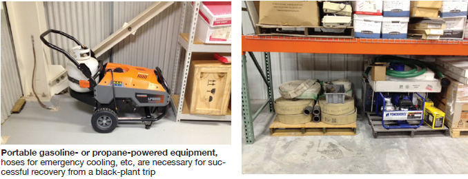

  • The plant should have been equipped with sufficient portable gasoline- or propane-powered equipment (water pumps, light plants, generators, etc) to meet the demands of an extended black-plant event (photos).
