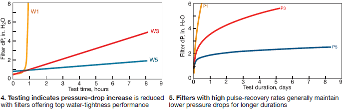

Water-tightness. Much like dust that escapes an inefficient filtration system, water also can impact turbine performance. Moisture that enters the airstream can introduce dissolved salts and other solids. Compounds such as iron oxides, chlorides, and other contaminants can cause corrosion over time. Turbine blades then have to be repaired and re-balanced—another expensive maintenance task and contributor to extended downtime.

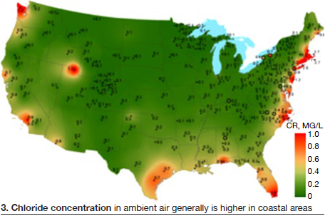

Water-tightness is particularly important in coastal areas, with salt-laden ocean moisture subjecting equipment to accelerated corrosion. Consequently, protection from saltwater represents a key factor affecting the life of gas turbines. OEMs usually recommend that less than 0.01 ppm of salt enter their gas turbines.
In coastal environments, airborne salt can easily range from 0.05 to 0.5 ppm on a typical day. According to data compiled by the National Atmospheric Deposition Program, chloride concentrations in the atmosphere along coastal areas are sometimes more than 10 times the concentrations of inland areas (Fig 3).
Petrochemical environments also present challenges, as hydrocarbons can enter the airstream without adequate water-tightness. These products can place gummy deposits on blades and adversely affect performance.
Water-tightness should be simple for an operator to evaluate. Ask your filter supplier to provide an independent laboratory test report verifying that a particular filter option is watertight and if not, how it will perform under wet conditions.
Donaldson developed a new methodology for testing filters in a controlled environment to determine how much, if any, water can pass through a filter. The test directs a 60-liter/hr water spray at the filter over an 8-hr period. The filter pressure drop and volume of water passing through the filter are recorded.
Based on this information, the company rates its gas-turbine filters on a scale of W0 to W5, with higher values indicating greater water-tightness. A filter rated at W0 would not be able to withstand any moisture, while a W5 filter could survive the test with at least 99.5% water stoppage and no more than a 2-in.-H2O increase in pressure drop. Donaldson has tested and rated its most commonly used GT air filters on this scale of water-tightness. Fig 4 shows how higher rated filters reduce the increase in pressure drop over time.

The relationship of recovery rate and pressure drop can be seen in Fig 5. This graph illustrates how long three filters with various pulse-recovery rates maintained acceptable filter pressure drop over time in a simulated dust-challenged environment. Generally, filters with higher recovery rates maintained lower pressure drops for longer durations.
