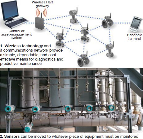

Siemens’ system uses wireless technology and a communications network (Fig 1) to provide a simple, dependable, and cost-effective means for diagnostics and predictive maintenance. Wireless sensors allow Midulla to capture the measurements needed for equipment analysis.  These data are transmitted through an access point (a/k/a “gateway”), and on to the control room, as well as to the Siemens Power Diagnostics® Services facility in Orlando. Last offers an avenue for Siemens to assist in troubleshooting problematic readings.

Another valuable aspect of Midulla’s wireless system is the ability to move sensors to whatever piece of equipment that might need monitoring, streaming important data to plant personnel for data-driven decisions (Fig 2). The technology has exponential growth capabilities, with the possibility of expanding the number of sensors used to monitor the overall performance of the plant instead of just one piece of equipment at a time.

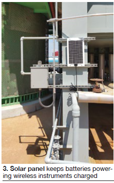

In addition to creating a valuable stream of actionable data, Siemens Wireless Technology made use of a renewable energy source to power the system. A solar panel was installed on the site next to the pressure transducer’s junction box (Fig 3). The solar panel maintains the two 24-V batteries that power the pressure transmitters.
