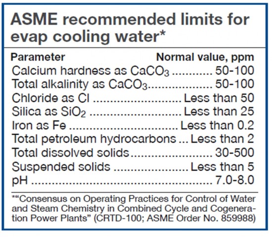

Daniels urged users to redouble their efforts to filter out suspended solids from evap cooling water and to install and diligently maintain filters on evap-cooler recirculation pumps where they do not exist. He then displayed the cooling-water specs for this service as recommended by ASME (Table). Daniels closed by suggesting users also check with their media suppliers to see if they have additional requirements for cooling water.
