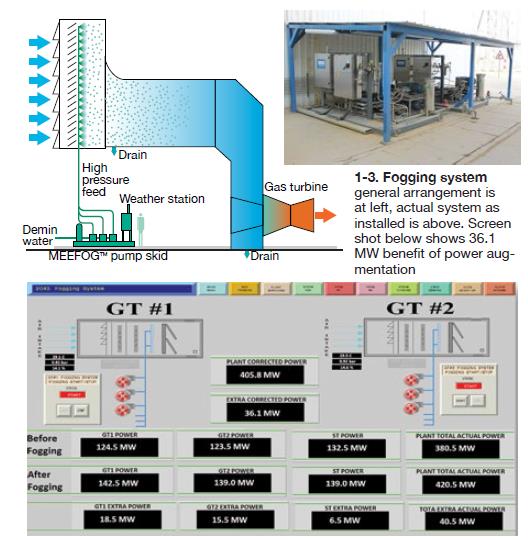

To increase plant output, management decided to install a fogging system, manufactured by Mee Industries Inc. After a review between fogging technology and chilled water technology, plant staff concluded that the fogging system consumed less auxiliary power, had lower capital costs, a shorter payback period, and could be installed much more quickly. The only drawback was increased water consumption (Figs 1-3).
Results. Fogging-system implementation now is considered a “success story” both inside AES Corp and in the region, as this was the first project of its kind in Jordan. Improvements in plant revenue by increasing capacity and efficiency now give Amman East the opportunity to sell extra capacity during fogging operation. Plant personnel take great pride in the project; the facility is considered an example of innovation and development in Jordan.
Operational data tell the story for the project’s success:
  • Improved heat rate by 28.4 Btu/kWh.
  • Increased gas turbine output (two units) by 20 to 50 MW, depending on weather conditions.
  • Reduced NOx emissions by 10 ppm (each turbine).
Other benefits include:
  • Reduced the plant’s equivalent forced outage rate (EFOR).
  • Improved the plant’s commercial position in its PPA.
