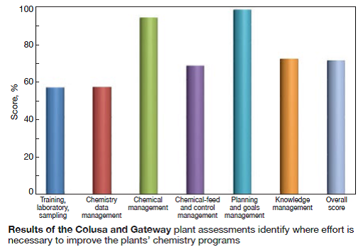

A WorleyParsons technical consultant worked with the O&M teams from both plants to develop assessments for each area. Program components are scored using a weighted scale so team members understand what the most important items are and what areas need the most focus and improvement (bar chart).

Results. The steam-cycle performance assessment provided a detailed review of the overall chemistry program. This helped guide the plant staff to critical items for focus and improvement in the plants’ chemistry programs. This will reduce maintenance costs in the future as the programs, policies, and processes are optimized.
Several recommendations were made, and are being actively addressed, from the initial assessments to help improve the programs. For both facilities these included:
