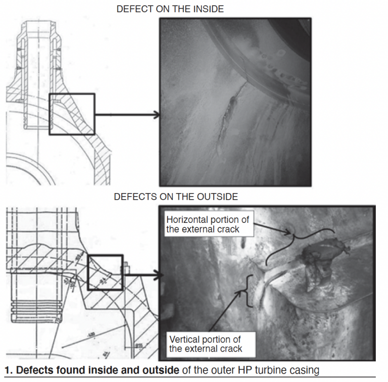

Casting weld defects have become a significant industry concern.
Ronnie Scheepers, Eskom, South Africa, discussed acceptability assessments of casting weld defects under transient thermal loading. The basis of this presentation was weld repair of castings during both manufacture and operation, emphasizing the need for qualified welding procedures and strict quality control.
In many cases, cracking (on initial assessment) is attributed to in-service creep damage accumulation. However, consideration of specific geometry and operational stress distribution often suggest stress relief or reheat cracking because of an original manufacturing weld repair.
“Weld repair of castings during manufacture,” he stated, “is a well-known and acceptable practice if conducted in accordance with approved standards and procedures. However, cracking of these weld repairs in high-temperature and ageing plants, especially those operating beyond design life, is all too common.
“Structural-integrity assessments of such components must not only consider reduced material toughness caused by temper embrittlement, but also the stress intensities generated during transient thermal events, such as start/stops and quenching incidents,” he continued.
“Most defects are detected during outage inspections of in-service plants,” the speaker explained. “The focus then becomes a management strategy of replace, repair, excavate, or leave as-is.”
The first of two case studies presented by Scheepers discussed the acceptability of weld-repair defects in the outer casing of an HP turbine. This 1980s-vintage unit for a 618-MW site had logged 220,000 hours and 328 starts. Material of manufacture is GS17CrMoV5-11 (1.7706). Operating conditions are 4.3 MPa at 330C to 430C.
Phased-array NDT showed an internal defect about 48 mm deep in a wall of 114-mm thickness. An external vertical defect was about 78 mm deep where wall thickness (WT) was 108 mm; an external horizontal defect about 63 mm deep (108 mm WT). Refer to Fig 1. Remaining ligaments were clear of indications.
Microstructural evaluation showed a mixture of ferrite and mostly bainite, and confirmed cracks in both the weld and in the heat-affected zone. Cracks were oxide-filled with decarburization along crack lengths, and no indications of propagation.
Metallurgical assessments concluded significant temper embrittlement had occurred. This was considered in a finite-element-based structural-integrity assessment that reflected design operating conditions as well as a hypothetical quenching event.

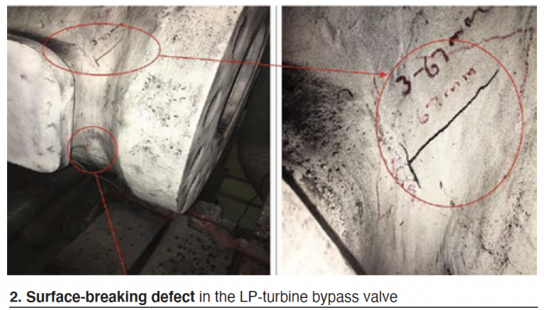

A second case considered an LP-turbine bypass valve, 1980s vintage from a 686-MW unit with 190,000 hours and 155 starts (Fig 2). Operating conditions were 4 MPa/535C during startup and shutdown; the baseload operating temperature, 248C. Material: GS17CrMoV5-11.
A 67-mm-long surface-breaking defect was identified by magnetic-particle test (MT); phased-array ultrasonic testing (PAUT) indicated a depth of 44 mm within 65-mm wall thickness. No other defects were found. A macro crack in the weld repair area was oxide-filled and micro cracks were found with stress-relief voids.
Weld repair had not been reported during manufacture.
In this case, the material temper embrittlement was found to be less severe, but the criticality of pre-warming to reduce transient thermal stress and, by extension, crack stress intensities during trips or shutdowns, was clearly demonstrated.
Remaining life assessments, in both cases, considering creep or fatigue crack growth and allowable defect sizes concluded the defects to be acceptable for operation to the next planned outage.

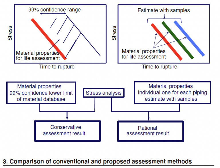

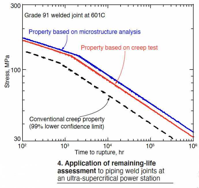

Using data scatter
“There is a large amount of scatter in the creep properties of welded joints of the steels; however, the scatter is not considered in conventional remaining-life assessments of welded joints of in-service piping.” This was the presentation opening by Masatsugu Yaguchi, Materials Science Research Laboratory, Central Research Institute of Electric Power Industry (Criepi), Japan.
“Thus,” stated Yaguchi, “we have developed a new method of assessing the individual creep properties of welded portions of actual pipes.”
This presentation explained the assessment method and described the actual implementation for Grade 91 steel, as an example.
The premise: “Data scatter (heat-to-heat variations) has not been considered for remaining-life assessment. Test specimens are taken to conduct creep tests and to analyze the data, but there is no data for the actual component.”
In Japan, the common method of remaining-life assessment for materials is the 99% lower-limit curves for data obtained at various temperatures, on a typical stress versus time-to-rupture diagram.
The question remains: “Is the 99% lower limit, or minus-20% strength, really ‘the weakest?’  Also, materials used in creep tests do not cover all specification ranges of Grade 91 steels (Fig 3).”
“Therefore,” stated Yaguchi, “consideration of heat-to-heat variations is important.”
The institute’s program objectives: Propose a life-assessment method considering heat-to-heat variations, develop a database and elemental technologies for Grade 91 welded joints.
In the method described, the creep property of the welded joint is related to that of each base metal because the creep properties of welded joints strongly depend on the creep life properties of the corresponding base metals.
Microstructure analyses and small punch creep tests on samples cut from the base metals at the outer surface of pipes in service were conducted, and the results were compared with a material database to estimate the creep property of each base metal of the target pipe.
The precision of the remaining-life assessment of pipes is significantly improved using the developed method because it can consider variations of the creep properties of their materials, which are not considered in existing life-assessment methods. Then, the method was applied to the welded joints of the pipes in ultra-supercritical power stations during periodic inspections, and remaining lives of the components were estimated (Fig 4).
