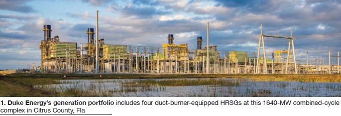

Duke Energy’s experience in preparing its HRSGs for cycling
“Controlling condensation is a major HRSG team focus,” explained Eugene Eagle, Duke Energy. “Our long-term goal is asset protection and reliability.” The company’s lead HRSG engineer addressed participants on Duke’s extensive experience with HRSGs in North and South Carolina, explaining how it is preparing HRSGs for cycling.
All Duke HRSGs are triple pressure with reheat, equipped for duct firing, and originally designed for baseload and load-following. Most are within 2 × 1 F-class 500- to 800-MW combined-cycle configurations (Fig 1).

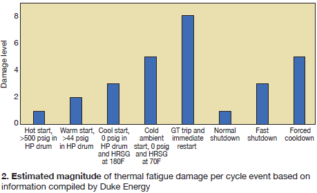

A summary chart on expected unit life brought clarity, comparing damage levels for the most common cyclic events (Fig 2). “Units designed for baseload service will need to be modified,” he stated, “especially for condensate removal. Proper attemperator operation is also critical.”
Condensation can cause thermal-transient fatigue damage, as mentioned several times during the Forum and in detail in “Trends in HRSG reliability, a 10-year review,” published recently in CCJ ONsite.

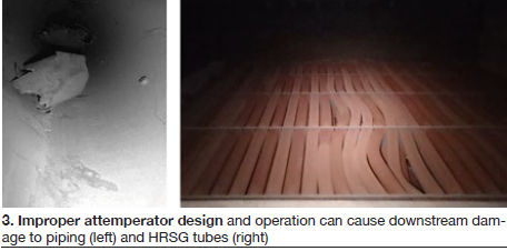

He then displayed severe attemperator damage (Fig 3) and offered some experience-based recommendations:
1. Avoid reducing HPSH/RH attemperator setpoints below 1050F. “It is better to overshoot on steam temperatures than to overspray to saturation.”
2. Never place the HPSH/RH attemperator temperature control valve (TCV) into manual control or reduce temperature setpoints. This will cause overspray conditions and significant pressure-part damage.
3. Upgrade attemperator block valves to metal-seated ball valves (bi-directional seats).
4. Use a TCV martyr/block valve master arrangement.

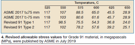

ASME recently reduced the allowable stress values for Grade 91 (Gr 91) steel, a topic anticipated and discussed at length in the previous HRSG Forums. “It was not a decision taken lightly,” explained Jeff Henry of Applied Thermal Coatings—Combustion Engineering Solutions (ATC-CES), Chattanooga, Tenn. Henry currently chairs ASME’s Working Group on Creep Strength-Enhanced Ferritic (CSEF) Steels (Fig 4).
When reviewing the table, keep the following points in mind:
  • The distinction made between tube wall thicknesses in the 2017 Code no longer is viewed as meaningful.
  • Type 2 Grade 91 material has tighter restrictions on certain residual elements—such as copper, arsenic, tin, etc—than Type 1 material. The “cleaner” Type 2 offers better rupture ductility.
  • Data presented in Roman type are governed by tensile or yield strength; that in italics by creep strength.

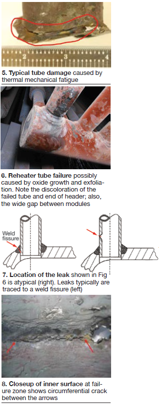

Anderson and Dooley then presented data and experience discussed recently at the European HRSG Forum about reheater tube failures apparently influenced by internal oxide growth and exfoliation. The referenced plant is an 800-MW 2 × 1 IPP near Bilbao, Spain, that began commercial operation in 2003.
This installation includes horizontal triple-pressure HRSGs behind 9FA+e gas turbines upgraded to DLN2.6 in 2015.
Since 2011, the plant has been moving toward more frequent starts and fewer operating hours per cycle. Currently, unit operations rotate with one unit down for a week.
Thermal mechanical fatigue was causing recurring leaks in the No. 2 reheater. Typical tube leaks caused by thermal fatigue are shown in Fig 5.
In the case presented, however, a reheater tube failure occurred on the tube side of the tube-to-header weld (Figs 6 and 7). The possible cause investigated was oxide growth and exfoliation.
RCA sampling showed an ID surface gouge where oxide was spalling off. See the circumferential crack in Fig 8.
No baffles exist between modules in this HRSG and tubes next to the gaps had operated at higher temperatures than those in the middle of the module. Partial tube blockage with exfoliated oxide was the apparent cause.
As Anderson explained, even a 3- to 4-deg-F temperature increase can accelerate oxide growth significantly. If the tube at the gap is running hotter than its neighbors, this could mean thicker internal oxide which would further increase tube metal temperature. Any resultant tube flexing could cause the spalling.
This analysis continues, and thermocouples are being added to tubes at the gaps at the side wall, at the module ends, and well away from the gaps.
Questions regarding this ongoing investigation included ability to determine remaining life of a reheater using oxide scale as an indicator. Another posed question: How do you know whether the issue is temperature rather than geometry? The answer: This particular case is showing a natural progression of a T22 tube impacted by increased temperature.

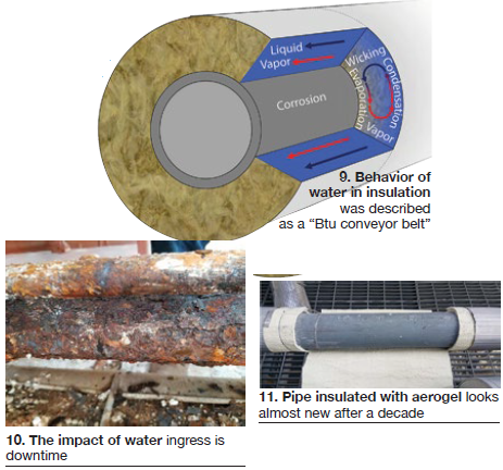

Impact of water ingress into insulation
Anthony Cosenze offered Aspen Aerogels’ inaugural presentation at the Forum, focusing on how water reacts within HRSG insulation systems potentially leading to corrosion under insulation (CUI).
“Aspen Aerogels has been protecting insulated pipes and materials in the petrochemical industry for more than a decade,” he stated. Cosenze explained water’s behavior within insulation as a “BTU conveyor belt,” a process of wicking, evaporation, capillary action transport (vapor), and re-condensation (Fig 9).
He followed with a case study from a US combined cycle involving a pinhole leak and ingress through a penetration seal with mineral-wool insulation. He likened the result to “a wet sock.” The insulation was removed, revealing significant OD corrosion (Fig 10). Next, Cosenze showed a photo of a pipe insulated with Aerogel after 10 years of operation (Fig 11).
HRSG examples discussed included penetration seals, HRH line bottom seals, and floor seal/boiler casing insulation integration systems.
A strong feature is reduced thickness and weight. Cosenze explained that a 2.8 in. thickness of aerogel/Pyrogel® offers the same insulating capability as 7 in. of calcium silicate or mineral wool, and is more hydrophobic (organic silicone base). Aerogel is lighter in weight (insulated pipe weight) with less wind loading, and is reusable.
