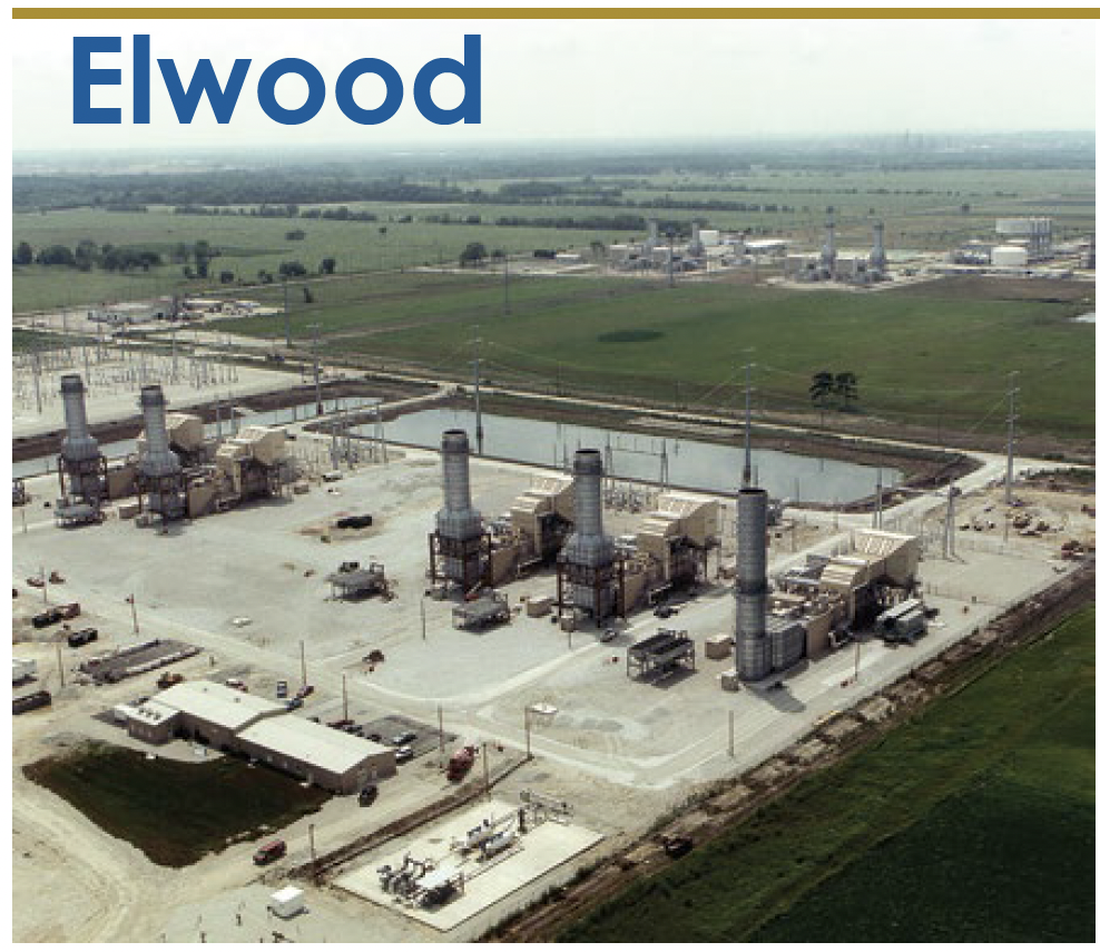

Elwood Energy, Owned by J-Power USA, Operated by NAES Corp
1350-MW, gas-fired, nine-unit, 7F-powered peaking facility located in Elwood, Ill
