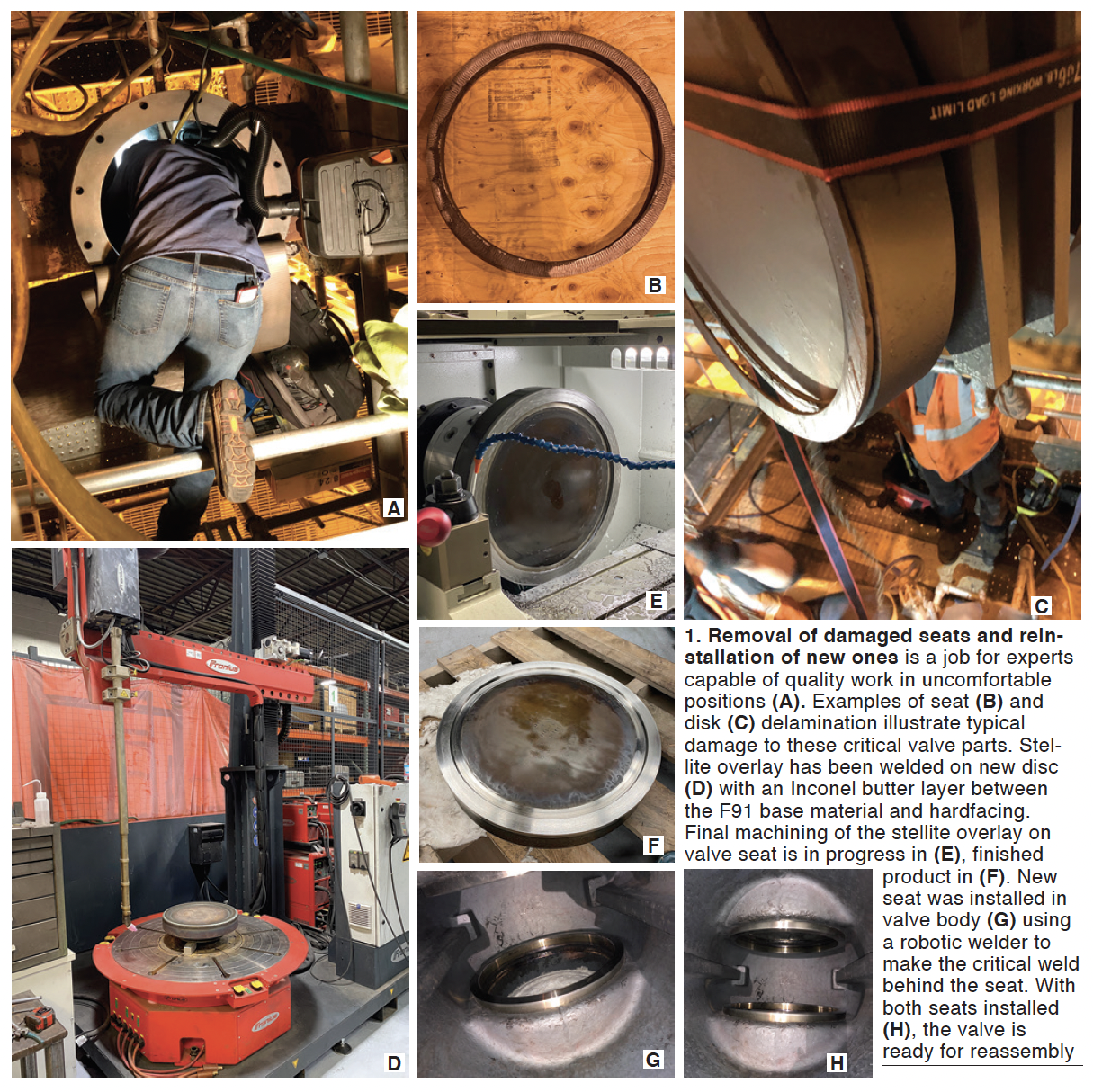

Millennium Power refurbished four HP valves (isolation and blending) on the affected boilers to return the combined cycle to full power as quickly as possible. Work on the valves was completed in-situ a day ahead of the eight-day schedule. Plant’s plan is to address damage to other valves suffering delamination, as necessary, during future scheduled outages.
In preparation for the fall 2020 outage, Millennium got the repair effort on the two HRH blending valves moving before the outage began by making new seat rings in its shop, Florek touting the company’s ability to reverse engineer and typically make any manufacturer’s valve parts in less time than it would take the vendor of record to supply them.
The first step in the repair process was to remove damaged parts and prep the valves for new parts and hardfacing—something Florek says the company has done at least a couple of dozen times to date. Follow key steps in the montage of photos incorporated into Fig 1. He added that sometimes just the hardfacing is damaged, not the basic part. In such cases it’s sometimes possible to remove the coating and reapply Stellite with the requisite butter layer.
Millennium Power’s field service personnel moved in short order from this project to another in the region where two 24-in. parallel-slide gate valves were refurbished within two weeks. Old seats were removed, new seats manufactured with Stellite overlay and Inconel butter layer, and the valves rebuilt, including new actuators. Original seat welds were found broken; one of the seats was severely deformed (Fig 2).
At the third plant in the Northeast that Millennium serviced within the three-month period noted above, a 24-in. wedge gate valve in the HRH system was scheduled for a stem replacement to mitigate packing wear. A new stem was manufactured in the company’s shop and shipped to the site for installation.
When technicians disassembled the valve, Stellite disbonding was found on the wedge and both seats. The owner approved corrective action the next day and Millennium’s field machining crew arrived onsite four days later to remove both seats while concurrently refurbishing the existing wedge in accordance with EPRI recommendations. Seats were replaced, wedge refurbished, and valve reassembled all within 16 days of project start.
