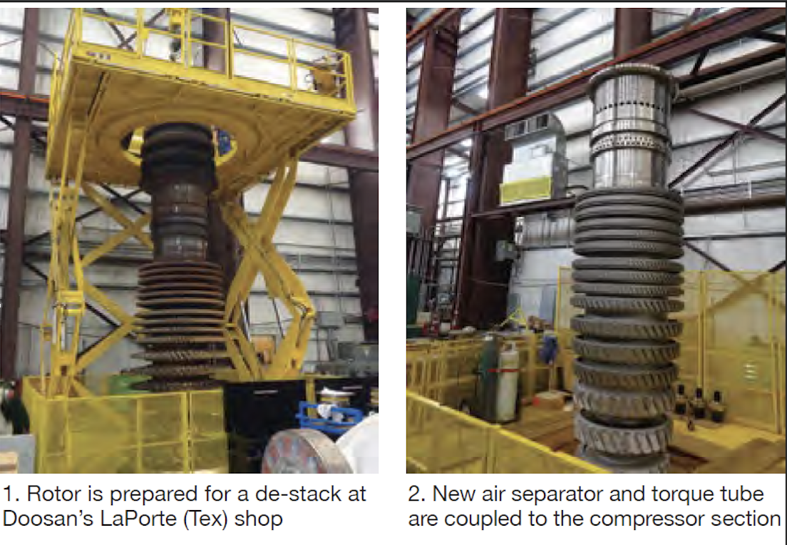

What is known is that the propagation of such cracks is slow followed by rapidly progressing high-cycle fatigue and failure. Early crack detection would allow for outage planning and parts acquisition before a vibration event. Inspection, however, requires de-stack (Fig 1) to access the affected zone, which is usually under the air sleeve. As of yet, there is no tried-and-true way to thoroughly inspect for cracks in-situ.

Component manufacturing. Immediately after de-stack at the DTS shop, reverse engineering began because component manufacturing was time-critical for delivery. White-light 3D scanning and metallurgical analysis of the existing torque tube and air separator started the process.
Doosan Heavy Industries, the parent company of DTS, had a turbine forging in Korea that matched the material composition; the forging properties were confirmed and rough machining commenced shortly after receipt of the rotor. A team of DHI engineers was sent to Houston to assist in the completion of the reverse engineering and characterization.
In the final stages of the project, DTS sent the 16th-stage compressor disk and the curvic adapter to DHI in Korea. The disk was properly matched to the torque-tube pins, the curvic adapter was mated, and the components were returned to La Porte for reassembly (Fig 2). Despite the added logistics, the project remained on schedule with enhanced repair integrity.

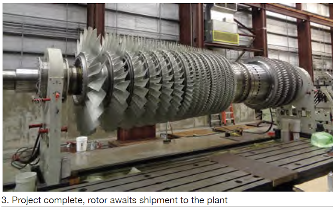

Also, during the rotor’s 69 days in the shop, DTS reverse engineered and manufactured three full rows of compressor blades for replacement, along with combustion hardware and diaphragms (Fig 3).
The components at the core of the project, namely the original torque tube and air separator, were found to have no damage. These parts were refurbished and returned to the customer as emergency spares for its fleet. Total outage duration was 100 days.
