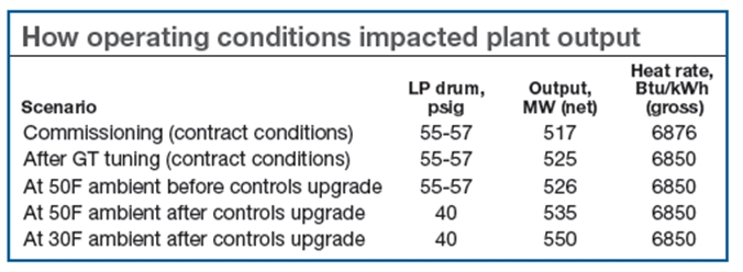

Challenge. Effingham County Power’s 2 x 1 F-class combined cycle had lower-than-expected cold-weather electric production because of condensate-system restrictions. The Southeast PowerGen facility, operated by Consolidated Asset Management Services, initially was limited to 517 MW, with a heat rate of 6876 Btu/kWh at ISO conditions, before a gas-turbine (GT) controls upgrade with GE OpFlex increased total plant generation by approximately 9 MW.
The winter following that upgrade, plant staff determined cold-weather performance was limited by the condensate system. Specifically, above 50F ambient, plant electric production was constrained by GT output, below 50F by the condensate system’s ability to supply a sufficient amount of water to the LP steam drums (Fig 1).
However, when planning the addition of inlet chillers to increase GT output, plant personnel noticed that the condensate-system limitation would affect operations over more run time because of a planned change in the winter operating profile from cycling to base load. Initial action involved evaluating the cost of upgrading the condensate system to boost its capacity.The HRSG’s LP preheater bypass originally was programmed for a set point of 75 psig to protect against cold-end corrosion. Actual LP drum pressures at base load were 55-57 psig, so the LP preheater bypass valves typically remained closed during plant operation. Above 526 MW, the condensate system was unable to maintain the desired LP-drum water levels—even with all three 50% condensate pumps in operation. This only limited output during winter operations because of the plant’s warm geographical location.
Solution. Effingham staff discussed various alternatives and believed condensate return flow could be increased, without capital expenditure, by lowering LP drum pressure. Plant technicians experimented over a period of several days by operating the LP preheater bypass manually to reduce LP drum pressure. By comparing condensate flow versus LP drum-level control valve position at various drum pressures, they verified that condensate return flow rates could be increased. For the lower LP-drum pressures, condensate-pump operating conditions were within the allowable pump curves, and adequate NPSH was verified for the boiler feed pumps.
Results. Using LP preheater bypass valves to lower LP drum pressure to 40 psig, plant output at 50F ambient was increased from 526 to 535 MW. At 30F, production could be increased to 545 MW with only two of the three condensate pumps running; with all three in operation, 550 MW was possible (table). Providing new logic for the automatic operation of LP-preheater bypass valves gives operators multiple options by simply changing the pressure set point. This operating change had a negligible impact on plant heat rate and was done at essentially no cost.
