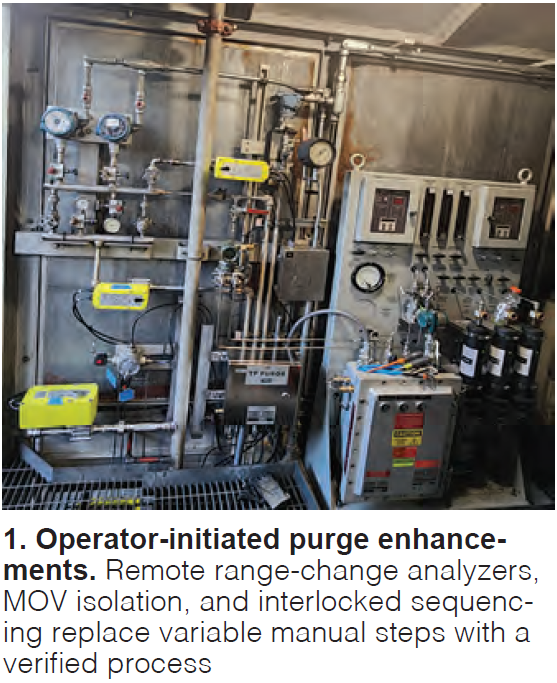

The automation package centers on three main elements: an upgraded gas-handling manifold, a non-powered CO2 vaporizer, and software integration within the existing plant control system. The manifold includes MOV hydrogen shutoff valves with feedback, dedicated CO2 supply and vent MOVs for top and bottom headers, and a pair of solenoids that direct analyzer samples from either header (Fig 1).
 Dual explosion-proof analyzers measure hydrogen, carbon dioxide, and air concentrations with remote range-change capability. The operator can switch measurement ranges from the control room without accessing the analyzer cabinet. A differential-pressure transmitter verifies that the analyzer is sampling live flow rather than a stagnant pocket of gas. CO2 flow meters and totalizers record the actual amount used, helping plants confirm the purge was completed.
Integration is designed for major distributed control systems such as GEV Mark VIe, Ovation, and Siemens T3000. This eliminates the need for an auxiliary PLC and allows purge records, alarms, and analyzer data to be stored in the plant historian for future audits.

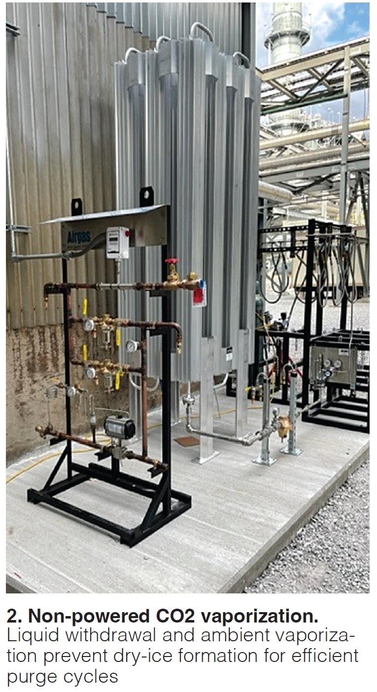

The bottleneck in many purges is CO2 delivery. When gas is drawn from the top of storage cylinders, the temperature drops, forming dry ice and choking flow. E/One’s solution uses liquid-withdrawal cylinders or micro-bulk storage combined with a passive vaporizer that converts liquid CO2 into gas using ambient heat. This approach provides stable flow of 6-7k standard cubic feet per hour at 50 to 65 psig without requiring electrical power.
Because the vaporizer is non-powered, it continues operating during a total station blackout. The only component that must remain energized is the flow totalizer, which can be tied to the plant’s uninterruptible power supply (Fig 2).
The design not only prevents dry-ice formation but also reduces CO2 consumption by roughly thirty percent, saving cost and shortening purge time to as little as one to two hours.

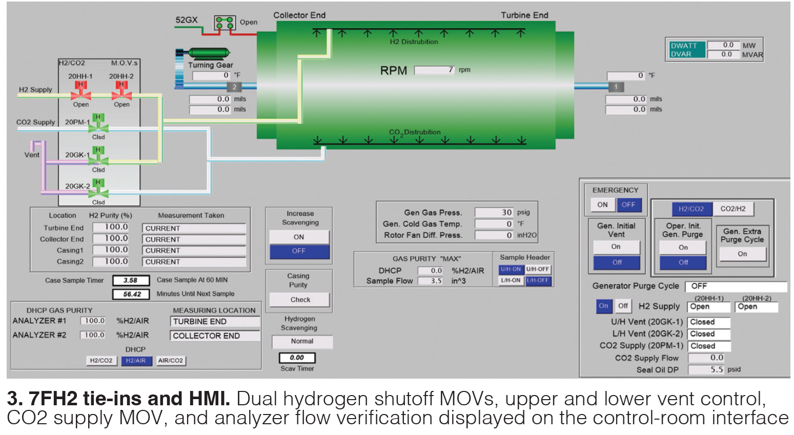

Justice, a seasoned controls expert, walked the audience through a series of simulations for each purge modality. The operator interface consolidates all purge information onto a single screen. It displays hydrogen purity for both ends of the generator, MOV positions, analyzer-flow DP, seal-oil DP, generator case pressure, and CO2 flow totals (Fig 3).
In maintenance mode, the logic pauses the sequence if seal-oil DP falls too low, allowing operators to correct oil-system conditions before continuing.
In emergency mode, the system prioritizes hydrogen removal and finishes by holding the generator pressure to about ten psig with CO2 to maintain seal oil system integrity preventing seal oil back flow into the generator.
Manual valves remain in place for contingency. If an MOV fails or loses power, operators can complete the purge by hand. MOVs are designed to fail in position to prevent unintended motion during outages.
