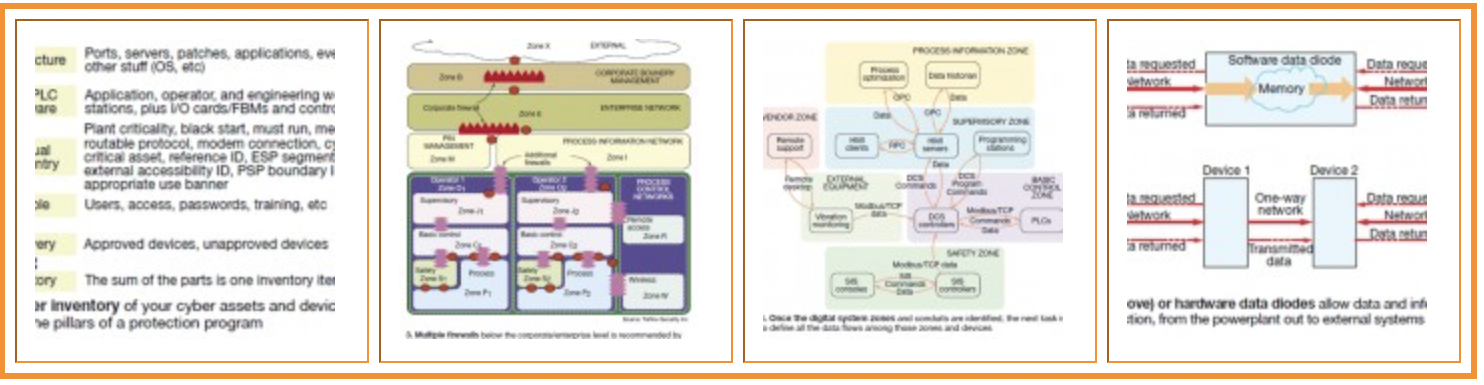

8. Inventory your cyber assets .In addition to guarding the digital perimeter, creating a thorough inventory of your cyber assets, and organizing them, is a pillar of a cybersecurity management program.

It’s one thing to create an inventory of cyber assets around critical infrastructure. It’s another to keep it up-to-date. Maintaining the accuracy and currency of any database is difficult. For digital automation systems, it all comes under the rubric of change or configuration management.
PAS Inc, Houston, which has built cybersecurity compliance solutions for a large owner/operator with multiple assets across a broad region, suggests the following categories for building a complete inventory: Infrastructure, DCS/PLC hardware, manual data entry, people, and discovery (Fig 2). Each of these categories, in turn, possesses certain attributes that can affect the health of the cyber asset, and therefore the ability of the component, as part of a critical asset, to function properly. It may look straightforward on paper, but now think about every component in your plant that can be considered a digital “point of entry.”

For example, Torfino Security Inc suggests dividing up the digital system into zones, identifying all conduits between and among zones, and then defining the data and information flow through those conduits. Additional firewalls can be established below the enterprise and corporate firewall levels (Figs 3, 4).
A third device for protecting the perimeter is called the data diode (Fig 5). As the name implies, the data diode allows data to be transferred in only one direction, or uni-directionally. It is inserted between a source of data at the plant control system and the computer system or network, and can be hardware- or software based. The hardware diode may be the more secure approach because a software diode can be accessed from the computer, or remotely, and “converted” into a bi-directional pathway.
