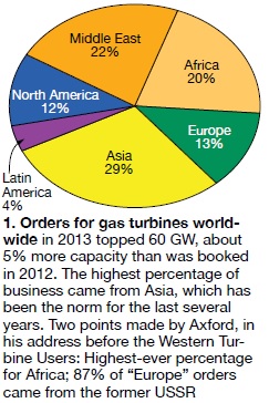

Worldwide, Axford had expected 5% growth and he nailed that within a few tenths of a percentage point. Geographically, 29% of the orders were from Asia, 22% from the Middle East, and 20% from Africa (Fig 1). Regarding Africa, the lion’s share of its orders was committed to Algeria, which bought nearly 9800 MW in 2013. Interesting to note is that Algeria’s generating capability at the end of 2011 was only about 11 GW.

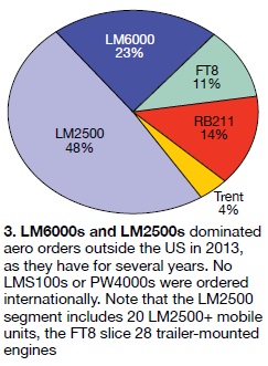

Fig 3 illustrates that aero orders outside North America were dominated by sales of LM2500 and LM6000 engines. By contrast, North American aero orders for electric generation service were a mixed bag: GE LM2500s, LM6000s, and LMS100s accounting for 5%, 15%, and 38%, respectively, of the total, and MHPS’s FT4000™Swiftpac®, 7%. Aeros purchased as compressor drivers were 13 PGT25+G4s, accounting for 27% of the total, and two Rolls-Royce RB211s, 8%.
Global orders for the popular LM6000 totaled 32 engines in 2013 down 10 from a year earlier. Only two LM6000s were purchased by US generators; none were sold into the Eurozone. Sales of the LMS100 rebounded from two in 2012 to six last year—all for US service, including five in California. To date a total of 62 simple-cycle units have been ordered, 44 for the US. Industry sources have told the editors that the premium price for the LMS100 might make it unattractive to at least some international prospects.
