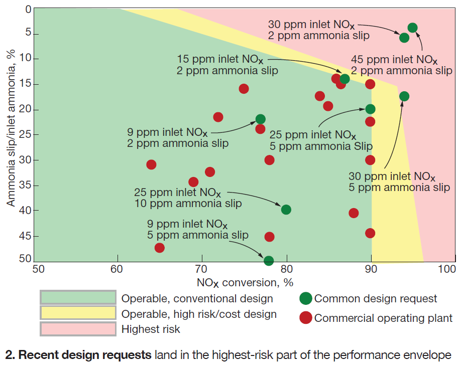

Fig 2 compares designs with different NOx-removal and excess-ammonia allowances, taking into account the complexity and operability of the designs. Note that most of the newest, higher-efficiency designs are in the “highest risk” zone where the risk of failure on commissioning is high and maintenance (catalyst replacement, catalyst cleaning, and ammonia tuning) is frequent and costly. All turbines, including the newest designs, are now required operate at low and variable loads to respond to dynamic grid demands. This is in due in part to the growing impact of renewable power. Output down to 20% load is not uncommon. Figs 3 and 4 show real-time operating data for NOx and CO emissions versus load for an advanced-class turbine. Most low-NOx/low-CO combustor technology is designed to function within guaranteed limits for NOx and CO above 50% load. Below that, NOx and CO increase rapidly because of suboptimal fuel/air mixing. These spikes in emissions at low load require the SCR and CO catalyst systems to achieve emissions reductions as high as 98%, far exceeding the capability of most designs.
