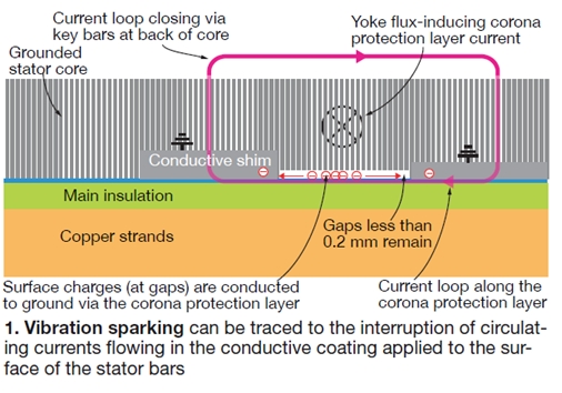

Vibration sparking, the co-authors explained, has its origin in the interruption of currents flowing in the conductive coating (slot corona protection) applied to stator-bar surfaces. These surface currents are created by magnetic flux in the stator yoke and are a normal occurrence in all generators.
However, by design, these currents normally are dissipated from the bar surface to ground through contact between the stator bars and core. The conductive corona protection coating on the surfaces of the bars, and the conductive filler material used to wedge the bars tightly in their respective slots, assure good electrical contact to the core (ground, Fig 1).

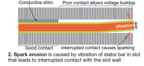

Vibration sparking occurs when the currents flowing in the corona protection coating are interrupted because of the movement of the stator bars relative to the slot wall. These axial currents flow from one point of contact with the slot wall to another via the coating. If one of the contacts opens to interrupt the current then there is a risk of sparking—depending on the distance between contacts and the magnitude of the current (Fig 2).
This type of sparking can occur only when stator-bar vibration exists. One of the factors influencing arcing is the level of the induced voltage in the loop built along the corona protection layer via contact points to the core and the key bar (refer back to Fig 1). Thus the resulting current depends on the induction design data for the generator, the axial resistance of the bar corona protection layer (Raxial in ohms/meter), and the lateral resistance (so-called contact resistance) of the corona protection layer (rlateral in ohm-meters). The combination of the axial and lateral resistance is known as the contact coefficient, defined as:
When a stator bar is installed and wedged in the slot with poor side filling, or if there are inconsistencies in the slot geometry, voids or gaps are created between the bar surface and core iron. These voids, or gaps have electrical and mechanical consequences. For example, they reduce the contact coefficient when the contact resistance of the corona protection layer increases.
Additionally, without appropriate mechanical support, stator bars can vibrate in the slot, creating conditions conducive to vibration sparking. Operating time also impacts the risk of SE occurring.
High currents in the corona protection layer of the stator are exacerbated when material ageing and high temperatures contribute to reduced electrical resistivity of the conductive coating on the stator bars. The result is a decrease in the axial resistance of the corona protection layer. Bar vibration in the slot can be amplified over time by the loosening of radial slot wedges designed to maintain radial pressure on the bars and dampen vibration.
What the foregoing suggests is that the contact coefficient is a good indicator of vibration sparking risk because it accounts for both poor lateral contact between the bars and slot wall (risk of bar vibration) and low corona protection layer resistivity (risk of high currents in the corona layer).

Experience suggests that the nature of spark erosion is such that even if there is no visible damage on the bars at the vent-duct locations damage may already exist between the bar and the slot wall (Fig 4).
