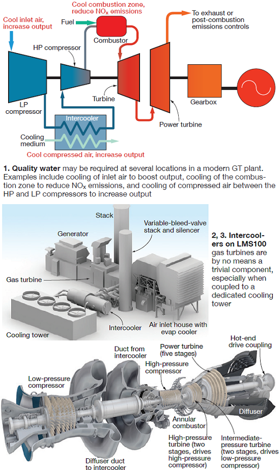

Even if you don’t have a steam cycle, chances are your gas-turbine plant uses plenty of treated water—for evaporative cooling or inlet fogging, water/steam injection for NOx control and/or power augmentation, and possibly as the cooling medium for intercoolers if they are incorporated into engine design (Figs 1-3). The quality of this water is critical to minimize deposition and corrosion problems.
It is doubtful anyone would dispute the importance of maintaining strict treated water quality characteristics or of having a reliable water treatment, storage, and feed system. In many locations, emissions permits dictate that if the NOx injection steam/water isn’t available, neither is the plant. Unfortunately, much of this water cannot be recovered and recycled as it is lost to atmosphere through the GT exhaust.
