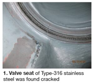

Challenge. Dogwood Energy Facility was experiencing internal leak-by on a 12-in. stop/check valve in the high-pressure (HP) steam system. The valve was opened with the expectation of needing to perform valve plug and disc machining and lapping to resolve the leak-by issue.
However, on disassembly, personnel discovered that the valve seat had cracked (Fig 1). The failure mechanism was differential expansion—that is, the Type-316 stainless steel seat and 9-chrome valve body were growing and contracting at different rates. The valve was reassembled and run as found until a suitable plan could be established to facilitate the repairs.

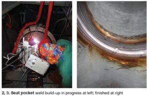

The last option on the table was to perform the repairs with the valve inline. There were inherent advantages to performing the work by this method. However, there was one major challenge: Finding a company that could do the work in a satisfactory manner. The inherent difficulty with the inline repair alternative was that the existing seat would have to be removed and welded back in through the throat of the valve as opposed to the back side of the seat in the steam line.
Machining the seat out should not pose a problem, but once again, procedures to weld the seat back in would require proper pre- and post-weld heat treatment. This would mean holding the valve at approximately 450F while the seat was welded into place. The seat pocket is located about 32 in. down inside of the valve throat. This is beyond—or at the limit of—an arm’s length at shoulder depth, which would preclude the technician from being able to look down inside of the valve while welding.
Even if the seat pocket were reachable, the technician’s hand and arm would be exposed to a temperature of 450F while welding. Robotic welding would be difficult because of the temperature environment as well. The first contractors consulted all recommended welding at the end of a stick and using mirrors.
After an exhaustive search, plant personnel found a repair company that had developed a water-cooled system for a robotic arm capable of welding and machining at the temperature required to do the work. The work was estimated at 11 to 12 days working around the clock; the cost would be approximately $188K.
The plant did not have an outage period scheduled for 2012 which would allow for 20+ days of downtime, so anything beyond a scheduled 10-day outage would make the plant unavailable for commercial operation. Cost, impact to the system, and timeline all pointed to performing the inline repair.

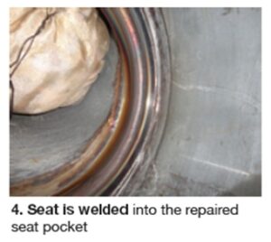

Once the valve was opened and the seat was machined out, it was determined that the seat pocket would need to be built up by weld repair, and then machined back to within spec (Figs 2, 3). After that was done, the seat could be inserted and welded in (Fig 4). The job went according to plan with exceptional results.
To minimize the chance of future failure of the seat from differential expansion, the valve manufacturer was consulted and said it was acceptable to replace the stainless seat with one of F91. This would match the material composition of the valve body.
Results. The project came in on time and well under budget with a final dollar amount of approximately $160K. There was zero impact to the schedule and system because the valve remained inline, thus minimizing the problems associated with line spring and subsequent piping alignment.

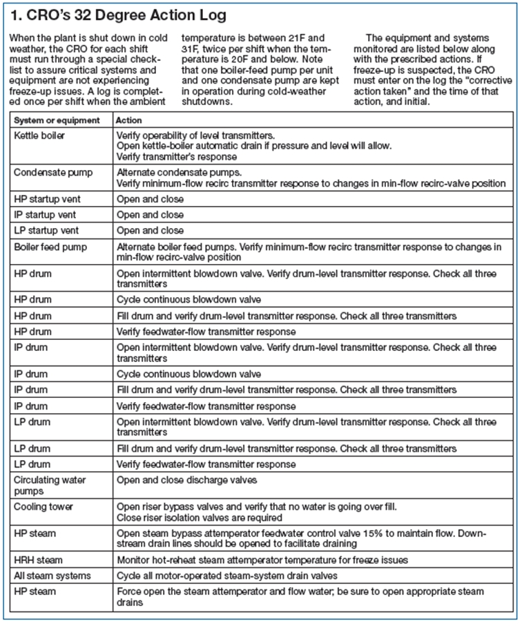

• CRO’s 32 Degree Action Log. This identifies equipment and systems that the CRO must check in cold weather to guard against freeze-up issues. Temperatures between 21F and 32F require the actions once per shift while temperatures 20 degrees and below require the actions twice per shift (Sidebar 1).

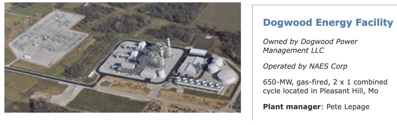

Challenge. Dogwood Energy Facility is a 650-MW combined-cycle plant located just outside of Kansas City. Its location makes it susceptible to a wide range of weather- related problems, exacerbated by having most of the plant located outdoors.
Since the plant is an independent power producer and operated by a staff of only 24, making sure the plant is ready to run at any time is very important. The biggest obstacle to availability is that the plant has to deal with the freezing temperatures, snow storms, and tornado season.

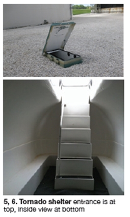

Tornados. Since the plant resides in an area known to have a high rate of tornadic activity, the facility decided to invest in storm shelters that would help protect staff and any contractors onsite (Figs 5, 6). Two storm shelters capable of accommodating 20 persons each were installed. One is located behind the main building and the other is by the contractor trailers. These shelters meet the following requirements:
