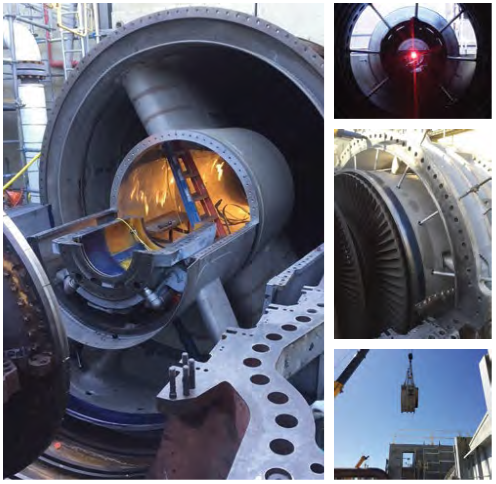

For the 501F, TOPS has developed both inspection-specific and outage-specific toolkits to suit customer needs. Wooster touted the company’s sustained growth in this market as TOPS added a major outage toolkit for six consecutive years. These resources are located strategically around the country (Nevada, Texas, and North Carolina) for rapid deployment coast-to-coast. Services for the 501F fleet now include:
  • Borescope inspections.
  • Basket changeouts.
  • Blade blending.
  • Four-way-joint leak repair.
  • Engineering.
  • Balancing.
  • Exhaust-cylinder removal and replacement.
  • Combustion inspections.
  • Hot-gas-path outages.
  • Major outages.
Expertise. With experience comes expertise and the TOPS culture stresses improving safety and efficiency for better customer outcomes. Several process-improvement initiatives and capital investments have brought about effective solutions for all units, including:
  • New system to pull generator fields.
  • A significant investment in the latest hydraulic tensioning equipment.
  • Mobile machine shop.
  • Innovative flange-spreading tooling.
Productivity and safety initiatives developed specifically for the 501F fleet are:
  • Blade-ring stands.
  • Dummy blade rings.
  • Top-hat bolting tools.
  • Roof stands.
  • Fuel-nozzle stands.
