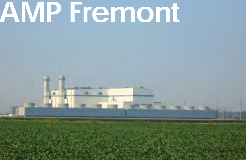

AMP Fremont Energy Center
Owned by American Municipal Power Inc
703-MW, gas-fired, 2 × 1 combined cycle located in Fremont, Ohio
Plant manager: Craig Bonesteel
