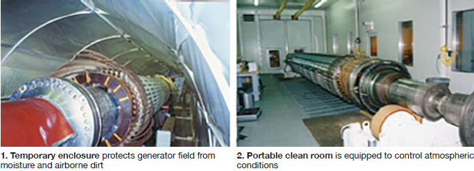

During shutdown, two conditions may exist: machine assembled and machine disassembled. For the assembled condition, there also are two conditions: hydrogen-cooled and air-cooled. For the former, it is necessary only to maintain a positive hydrogen pressure with dry gas.
For air-cooled generators, the challenge is much greater. Many designs incorporate heaters, and if they are functioning, and of sufficient size, moisture accumulation is unlikely. If not, moisture accumulation is likely to occur unless corrective action is taken—for example, forced ventilation with heated air, forced ventilation with dehumidified air, or a combination of both.
When a machine is disassembled and the rotor removed from the stator, preventing the ingress of moisture becomes more complicated. For the stator, on designs where the end covers can be replaced by temporary (plastic sheet or wood) covers, forced ventilation with heated and/or dehumidified air should be adequate.
For the rotor, on high-speed generators—for example, 2-, 4-, or 6-pole machines—an enclosure should be provided. This may be as simple as a temporary plastic sheet enclosure or a more complex transportable enclosure (Figs 1 and 2). In every case where humidity can be controlled using dehumidifiers and/or heaters (and cleanliness assured), it should be done. On low-speed units, such as large hydro-generators, control of humidity (and cleanliness) can be challenging.
