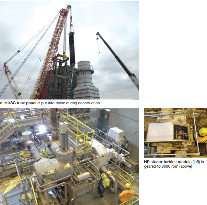

Features of the HRSG (Fig 6) important to the plant include: use of full penetration welds; sizing, routing, and locating suitable drain lines to enhance steam cycle roll-up; use of hangars and floating inlet and outlet headers on tube bundles; and use of high-strength drum and header materials (P91).
The VAX HP steam turbine module operates at 9000 rpm, and is geared to 3600 rpm between the turbine and generator shafts (Fig 7).
