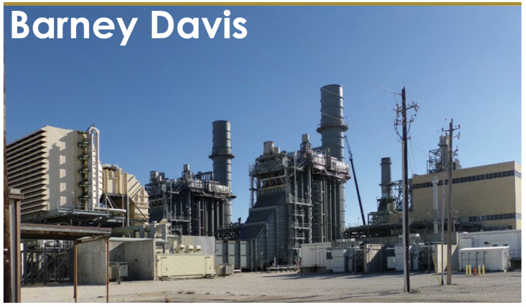

Barney Davis Energy Center, Owned by Talen Energy
Operated by Consolidated Asset Management Services (CAMS)
670-MW, gas-fired, 2 × 1 combined cycle located in Corpus Christi, Tex
Plant manager: Jay Langley
