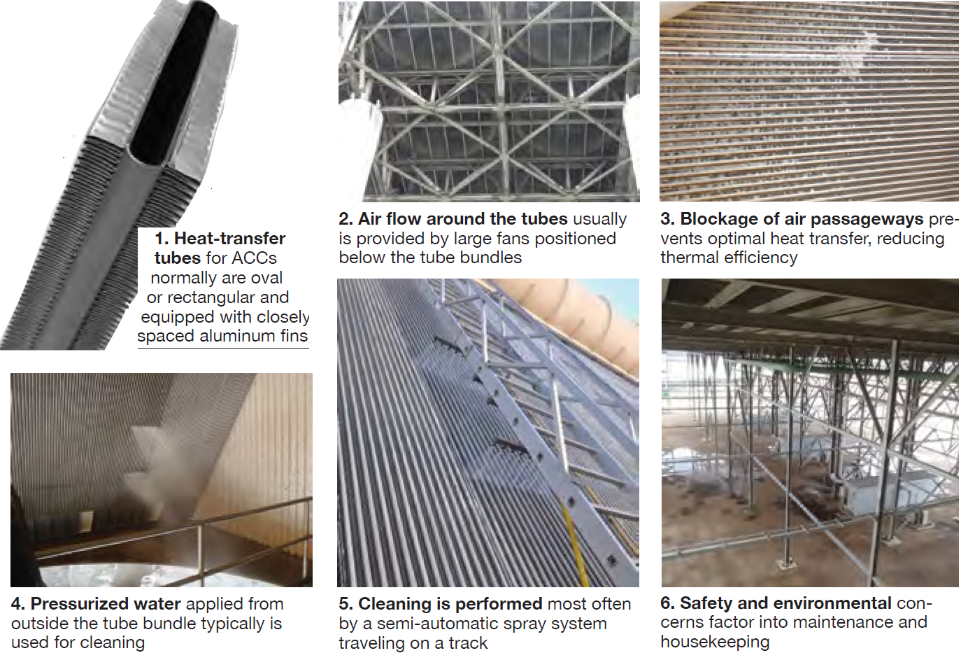

Air-cooled condensers use specialized heat-transfer tubing; the tube design most commonly employed today is aluminum-clad carbon steel tubes with exterior aluminum fins (to increase air-side surface area). Tubes are normally oval or rectangular with approximately 0.059 in. wall thickness and closely spaced fins (Fig 1). Over time, these fins become fouled with debris.
In most cases, air flow around the tubes is provided by large fans (Fig 2) positioned below the tube bundles, directing cooling air upward in a forced-draft configuration.
During plant operation, steam from the low-pressure steam turbine is directed via large ducts to the top of the heat-exchange tube panels. Moving down the approximate 36-ft tube length, steam is condensed by releasing its latent heat of vaporization, and the water returns (as condensate) to the steam generation process.

The cooling fans moving high volumes of air through the narrowly spaced fins will inevitably result in the accumulation of airborne debris on the fan side of the tubes. Blockage of air passageways prevents optimal heat transfer, reducing steam condensing efficiency (Fig 3). Debris is often site-specific, and may include vegetation (cottonwood seeds, leaves), trash, animal sources (birds or bats, feathers, flying insects), and local sources such as industrial byproducts (cement factory or coal dust, etc). One common and particularly troublesome foulant is oil from fan gearboxes.

The most common foulant removal method is pressurized water, applied from the exterior (top side) of the unit (Fig 4). This is typically performed by a semi-automatic system that moves multiple spray nozzles vertically on a track that can also be manually moved in the horizontal direction (Fig 5). Water quality and direction of spray are important to avoid fin damage and risk of tube corrosion.

Full implementation details are reviewed including safety and environmental concerns. Factors include equipment and water supply, personnel requirements, site planning, and the effect on other equipment and systems during cleaning (neighboring fans, water protection for electrical equipment, etc—Fig 6). Seasonal, temperature and safety recommendations are included.
