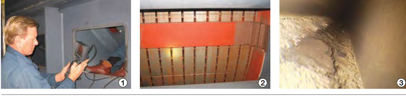

SE occurs when there is intermittent loss of contact between one or more stator bars and core iron. Because bar vibration is at fault, this deterioration mechanism sometimes is called vibration sparking. Moudy said SE is unique to manufacturers that do not use side ripple springs to maintain side pressure on the coil. He added that even if flat side filler is installed properly, insulation shrinkage over time creates additional gaps allowing SE to occur.
A borescope inspection is, perhaps, the best way to see first-hand if there’s any damage and to trend damage over time. Inspection frequency, Moudy said, depends on how the machine is operated and its condition. Access to the back of the core for borescoping is through panels (photo 1); core vents are accessible from the back of the core (2). Level 3 SE deterioration—slag/rough surface appearance over the vent duct opening is shown in (3).
Possible corrective actions: flat filler replacement with ripple springs, epoxy injection, or stator rewind with the latest preventive measures.
