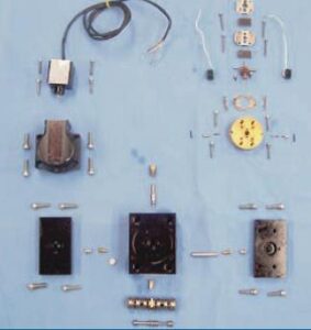

Design/operation. The oft used nozzle/flapper type of servo has two main parts, Gary Morrison of United Servo Hydraulics Inc, Waynesboro, Va, told the 501D5/D5A Users at their annual meeting last June: a torque motor and a bushing/spool assembly (Fig 1).

Valve works this way: An electrical input signal induces a magnetic charge in the armature and causes a deflection of the armature and flapper. This assembly pivots about the flexure sleeve and restricts fluid flow through one of the two nozzles shown in the diagram.
Assume that the right side of the flapper moves closer to the right nozzle, thereby creating higher pressure in the right passage and lower pressure in the left passage. The higher pressure in the right passage acts on the right end of the spool, applying force ing to displace the spool to the left. At the same time, lower pressure is acting on the left side of the spool, creating a force imbalance and facilitating the spool’s movement to the left. As the spool moves, the supply pressure port on the left opens to the adjacent control port and the return port opens to the control port on the right.
Spool motion is transmitted to the ball end of the feedback spring, creating a restoring torque on the armature/ f lapper assembly. Once the restoring torque becomes equal to the torque created by the magnetic forces, the armature/flapper assembly moves back to the neutral position and spool movement stops (fluid pressure on both sides of the spool are in balance)—that is, until the input signal changes.
Two things to take away from the foregoing:
1. Spool position is proportional to the input current and, with constant pressure drop across the valve, flow to the load end of the servo is proportional to spool position.
2. Nozzle openings must be “as new” and nozzle/flapper spacing precise to assure proper servo response. Also, sharp metering edges on the bushing/spool assembly are critical for accurate flow.

- Stock spares of each component in the plant warehouse (photo).

Other wear points that impact servo performance include flapper (Fig 3) and nozzle erosion and wear (Fig 4), and flattening of the ball at the bottom of the feedback spring (Fig 5).
