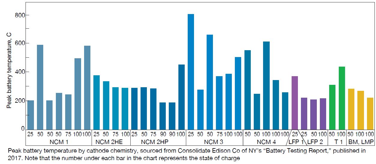

Batteries, however, chemically and physically degrade; deviations from ideal operating temperature can have “severe consequences” on battery cell life (chart)—just think of your digital devices. Parasitic energy is consumed to maintain that ideal temperature within the enclosure. Assuring uniform flow of coolant around battery pack outer enclosures is essential, but a challenge.
