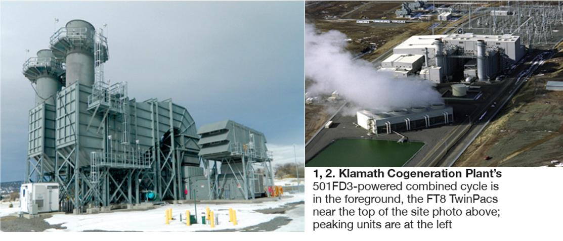

The Klamath plant site includes a combined cycle with an ABB Bailey DCS control system (Figs 1, 2). Installing an ABB DCS would seamlessly integrate the two facilities. Ultimately, the ABB DCS was the option selected. Klamath had a very good relationship with ABB and all parties involved recognized the challenges of retrieving the necessary logic to recreate it in the new control system.

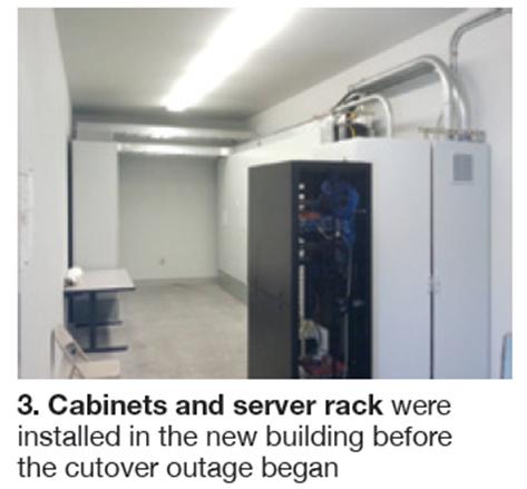

While data were being collected, the cabinet layout was designed and cable runs were considered. Plus, an addition to the control building was planned for these reasons:
• To reduce the time required for the cutover outage. The ability to have the cabinets in place, cable trays installed, wire pulled, and a desk with layout space contributed to this goal (Fig 3).

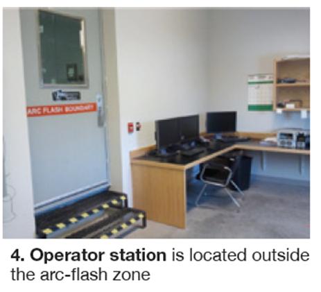

• To allow the operator to control the plant from a desk-mounted HMI located at a safe distance from the arc-flash potential of the Pratt & Whitney control cabinet (Fig 4). The existing cabinet had the HMI directly in front of the 13.8-kV generator breaker. All TwinPac control cabinets supplied by Pratt & Whitney place the operator inside the arc-flash zone, presenting a serious hazard during operation of the generator breaker.

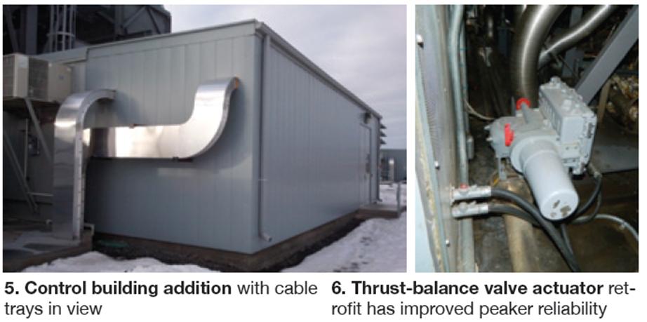

The option of having ABB provide a pre-manufactured building was evaluated. A cost/benefit analysis proved it was less expensive to construct a building with local contractors than to purchase, transport, and install a pre-fab unit (Fig 5). Plant staff contributed to the cost saving by doing the electrical install, including NERC-required cameras and badge readers.
Another major upgrade permitted by the control-system change-out was replacement of the thrust-balance valve actuator. The original actuator was pulse-activated and only had limit switches to indicate “open” or “shut.” A new EIM actuator with full-range feedback was installed (Fig 6). The controls project also allowed engineers to create a standard PID loop for more accurate control.Additionally, the purpose-built structure is larger than any building that would be capable of over-the-road transport. The larger floor plan accommodated engineers and the drawings required in support of the commissioning effort. This space is now used for storage.

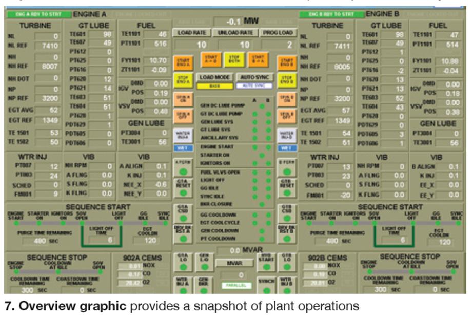

• The ability to tune the engines, make BOP changes, and modify graphics to aid in operations now resides at Klamath (Fig 7).

• Removing the ammonia-control PLC and integrating that system into the DCS has produced meaningful positive results: New graphics, transmitters that replaced switches, and more precise valve controls enabled plant personnel to greatly improve system performance. The water injection curve is now under plant control, allowing greater turndown while staying in emissions compliance and increasing the operational flexibility needed to extend revenue opportunities.
• Alarm set points can be modified, along with the nomenclature of the alarm, to better assist operators in diagnosing problems.
