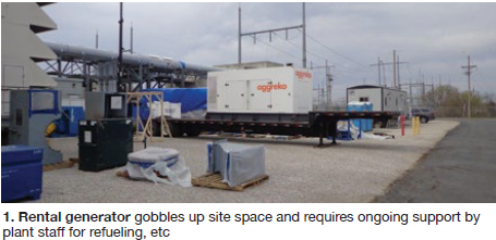

A large chunk of our budget went for a generator that was brought in on a flatbed 18-wheeler to run the air conditioning unit and desiccant dryer (Fig 1). Refueling this behemoth required outside support from a local fuel co-op, with the attendant safety concerns of transporting and offloading highly flammable fuels.

Results. On project completion we noticed some obvious and immediate benefits. First and foremost, we now enjoyed plenty of power availability throughout the plant. During the fall outage, Dogwood did not have to rent a single generator for additional power support. In addition, we were able to eliminate the large flatbed generator with its substantial footprint, which not only eased our budget but freed up space for better traffic flow and for equipment needed to support other projects.
Last but not least, we no longer required plant personnel to monitor or refuel the generating equipment. This was no small issue: when we did our first generator rewind, we had to have the flatbed generator refueled almost daily, which required coordination and scheduling to refill the plant’s 500-gal fuel tank every third or fourth day—including weekends. All of our needs for additional fuel support were virtually eliminated.
