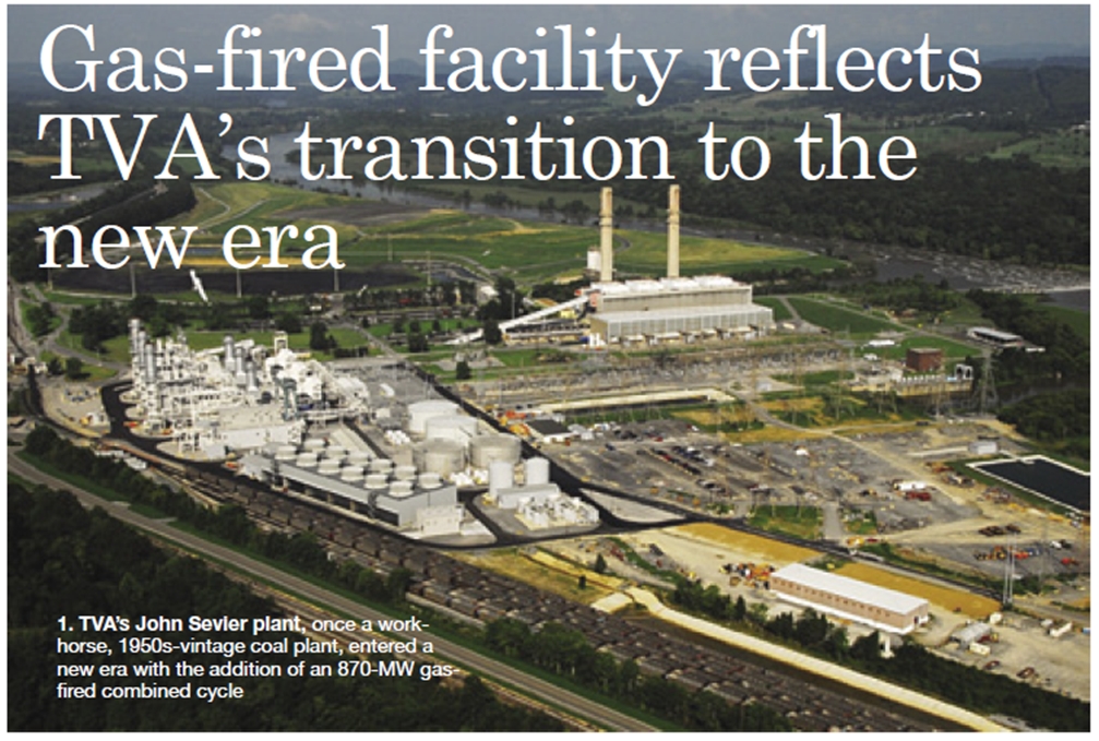

If you were searching for a powerplant where the industry issues you keep reading about have converged, you probably couldn’t do better than Tennessee Valley Authority’s (TVA) John Sevier Combined Cycle Plant. On a site where four 1950s-vintage unscrubbed coal-fired units no longer run, a state-of-the-art 3 x 1 natural-gas-fired combined cycle now operates at high capacity factor because of the favorable price of fuel (Fig 1).
The rail delivery line that you parallel on the long drive into the reservation is idle. The dust and grit of coal handling and preparation have settled. The tall coal plant stacks, built in the days of “the solution to pollution is dilution,” are stone cold, replaced by the short squat stacks typical of a gas plant.
As a TVA employee (of short duration) several decades ago, the writer worked on emissions testing and control projects at seven of the utility’s coal-fired plants. Although skeptical of the latest rhetoric around the shale-gas revolution over the long-term, he sensed while driving slowly under the canopy of trees lining the drive to the plant from the road, that he was being deposited into a different era. Time will tell whether the big switch from coal to gas becomes reality nationwide. But the stirrings of the new era whispered through the trees.

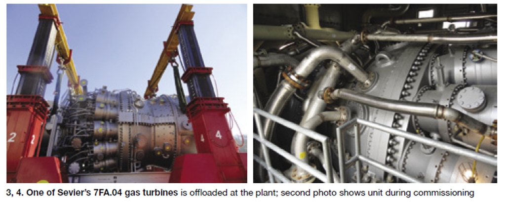

* Three GE 7FA.04 dual-fuel gas turbines equipped with evaporative coolers are each rated 176 MW on natural gas and 185 MW on distillate oil.

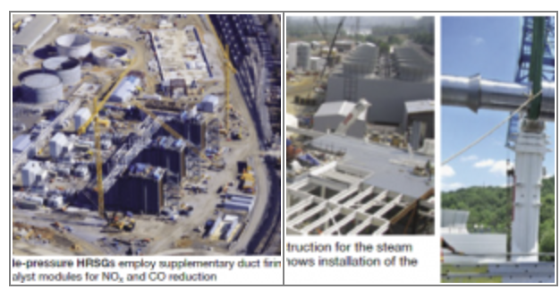

* Three triple-pressure HRSGs with duct firing are equipped with catalyst modules for NOx and CO reduction (Fig A). An aqueous ammonia (19.5%) storage and feed system serves the SCR system.

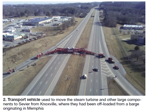

While it was convenient to include the existing ST/G in the design, getting the unit to the site was a different story. For example, the rail envelope for the generator was too large for East Tennessee (mountainous area). It had to be barged from Memphis to Knoxville, then trucked from there, including temporary closures of the busy Interstate 40 (Fig 2). The HRSG components were sized based on the rail envelope for the Gleason project. They also were shipped by rail to Knoxville and trucked from there to the plant.
The Toshiba Corp steamer was modified based on 10 years of field operating experience. Said Hoy: “The most invasive mod was replacing the single-bolt fan blade on the generator’s rotor with a two-bolt design.” The original bolts were showing premature fatigue on operating units in the field. Corrosion and missing parts issues also had to be addressed.

Gas turbines. The latest F-class turbines (Figs 3. 4) have exhibited no real issues to date. Compressor rubs have been detected, but no actions have yet been taken.

The construction team also remarked on some of the issues faced by the plant. “We were the first to receive this latest model gas turbine as a production unit, and we are experiencing some of the teething problems expected with that,” said GM Roger Waldrep, New Unit Services, Construction Projects. Many of these are associated with the Mark VIe controls software. “We’re all getting educated on how to run the heaters and the sensitivity of GT operation to fuel-gas temperature,” he added.

The original impetus for the project was TVA’s need to meet its obligations under the Clean Air Act, as well as an order by the US District Court for the Western District of North Carolina to install NOx and SO2 emissions controls on the coal units by Jan 1, 2012. Installation of clean-air controls on the coal plant could not be implemented in the original court-mandated time frame. Idling coal units and replacing the capacity with the combined cycle proved to be the best solution.
Adding 870 MW to an existing site naturally poses its own unique benefits and challenges. On the benefits side of the ledger, the combined cycle was able to take advantage of common air and National Pollutant Discharge Elimination System (NPDES) permits with the idled coal units. The plant has to meet annual tonnage caps for CO and NOx emissions. Also, the combined cycle shares the water intake structure of the old units. Although only four coal units were built at Sevier, the site was originally prepared for six.
In place for repurposing, of course, are the transmission lines to the coal units and a nearby 500- kV substation originally built to serve the Phipps Bend nuclear plant, which was never built, and to interconnect Sevier. One line from Sevier to Phipps Bend was used to tie two of the new GT/Gs into the substation, while a second line was used for the third GT/G and the ST/G.
