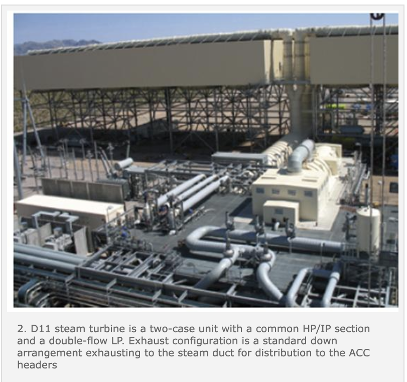

The D-11 steam turbine selected for Harry Allen is similar to the machines installed on the two Lenzie combined cycles: combined HP/IP casing with a double-flow LP section (30 in. last-stage blades) and configured for down exhaust. Generators are hydrogen-cooled.

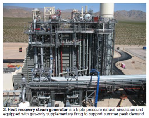

HRSGs. The heat-recovery steam generators are traditional natural-circulation, triple-pressure horizontal units equipped with gas-only supplementary firing systems to support summer peak-load demand. Steam conditions at full fire are 1900 psig/1050F/1050F. Vogt Power International Inc’s SMART-box design was selected to simplify construction. It modularizes the harps in groups to reduce onsite handling.
Oxidation catalyst and the SCR are designed to meet the permit limits of 2 ppm CO and 2 ppm NOx.
HRSGs feature a “double block and bleed” arrangement to permit operation in a 1 × 1 configuration if a boiler must be removed from service. The value of this capability was learned at Silverhawk when the transition-duct liner cracked on one of its boilers and insulation was sucked out, blinding downstream finned-tube heat-transfer surface. The entire plant had to be shut down to complete repairs and cleaning.
