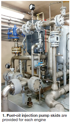

2. The fuel-oil injection pumps rely on a foreign-made back-pressure regulator known as the startup pressure relief valve. The lead time for parts is long and the manufacturer has no US representative.
The valve, when commanded, ports off sensing pressure through a needle valve and a solenoid valve. This allows a high-pressure (HP) setting, used for normal operation with the solenoid valve closed, and a low-pressure (LP) setting using the needle valve. The solenoid valve is actuated to temporarily switch the valve to the LP setting. This allows for pump startup and completion of the LP fill step in the fuel-oil injection sequence.

2. Several problems were noted with the startup pressure relief valves. These included the needle-valve adjustment drift attributed to a worn locking mechanism, and unrepeatability of the settings any time maintenance was performed on the valves. Any time these issues were addressed, the valve had to be tested.
Jim Sinodinos, senior operating engineer, recommended a way to test the valves. This was a challenge since the control system does not allow a pump start unless the fuel-oil mode is selected. Also, the pump’s motor controller does not have a hands-off-auto (HOA) switch.
Sinodinos developed a plan and coordinated the multi-step effort between the field and control-room operators to force a run on the pump. This enabled the pump to be tested in both the LP and HP modes by actuating the solenoid from the control room.
This practice allows any air, which causes unrepeatability of the valves, to be forced out after maintenance is performed on the valves. The plant has made this commissioning procedure a standard practice and it has allowed the maintenance team to troubleshoot and correct problems as required.
