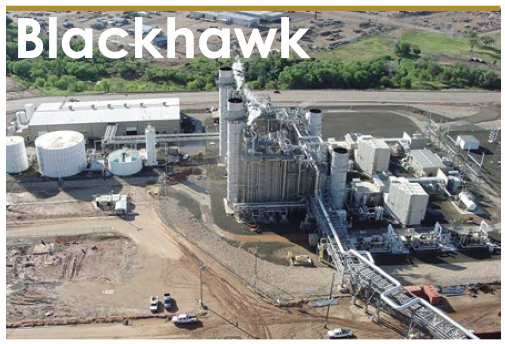

Blackhawk Station, Owned by Western Generation Partners LLC. Operated by CAMS
230-MW, gas-fired, 501D5A-powered 2 × 1 combined-cycle cogeneration plant located in Borger, Tex

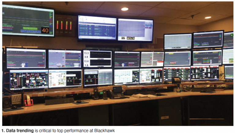

Solution. To help assure reliable steam and electric production, Blackhawk personnel implemented a PI trending system to track plant performance around the clock (Fig 1). This upgrade has proved effective in detecting potential problems and enabling timely fixes.

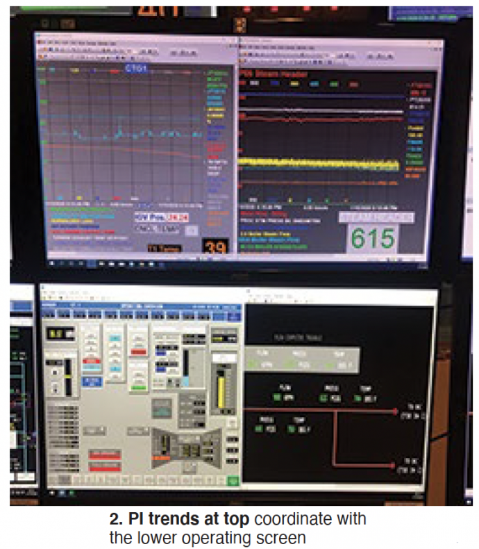

The PI system is used to collect data in Microsoft Excel and PI Processbook, thereby allowing operators to view trends on a computer screen above the DCS operating screen (Fig 2). Blackhawk currently runs a set of PI trends that coordinate with the operating screen. Example: If the DCS screen is on the drum and deaerator page, the PI trend above that screen will be trending drum and deaerator levels, valve positions, temperatures, and pressures.
Running PI system trends above the relevant DCS operating screen has proven vital to plant operation. The PI trends let the operators know exactly how their equipment is functioning. It has prevented equipment damage, unit trips, and environmental impacts, while keeping staff informed on how efficiently the equipment is performing. PI trends also assist as a great training tool, allowing new personnel to see how plant equipment and processes respond to operational changes.
