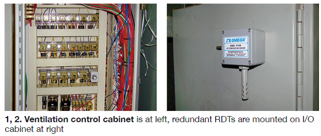

Challenge. Walton County Power is a simple-cycle gas-fired peaking plant with three Siemens V84.3A2 engines. The gas turbines are insulated and housed in individual enclosures which have a history of overheating, resulting in turbine trips and equipment damage. Turbine instrumentation, I/O racks, and PLC circuit cards are inside the enclosure and all are susceptible to damage from overheating.
Ventilation equipment consists of roof-mounted exhaust fans and wall-mounted intake louvers controlled by a complex series of thermostats, relays, and louver interlocks. The ventilation system has multiple single-point failure modes and no communications link to the control system. This means that if one micro switch on a motor-operated louver does not work, exhaust fans will not start and the enclosure temperature will rise without the control room operator knowing.
Another limitation of the system is that it does not provide a means of override if needed. Example: If a limit switch fails to make contact, but a technician can see that the louver is indeed open, there is no way for that technician to put the fan in manual and start it.
The failure of the ventilation system has caused the plant to experience full-load trips, resulting in significant loss of generation. The high enclosure temperatures have melted components within control cabinets and caused I/O card failures, resulting in loss-of-control of critical equipment—such as lube-oil pumps. During one overheating event the turbine tripped and damage to the I/O control cards prevented the unit from going on turning gear.
Solution. Several modifications were made to improve the system and reduce the likelihood of overheating. These mods were implemented by plant staff and equipment costs were less than $300 per unit.
One of the first improvements was the installation of manual override toggle switches. The switches override the louver interlocks to allow immediate cooling of the compartment (Fig 1). They were mounted to the exterior of the ventilation control cabinet for easy access. Next the control cabinet incoming power fuse was replaced with a breaker. This provides the technician quick visual indication while troubleshooting.
Finally, the system was integrated with the plant control system. Redundant wall-mounted RTDs were installed on each side of the turbine enclosure on I/O cabinets (Fig 2) and the temperature output was added to the DCS. Control-system logic was written that provides high-temperature alarms and control-screen graphics of actual temperatures. The logic also provides for outputs to control fans and louvers in the future.
Results. No further unit trips have resulted from enclosure overheating. The CRO now has immediate indication of enclosure temperatures and can quickly dispatch site personnel to correct the situation.
