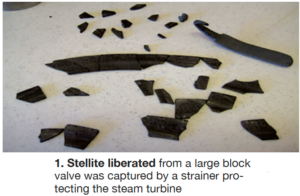

Valve seat delamination. The session moved on to a user describing damage suffered by a 262-MW D11 turbine at a 2 × 1 F-class combined cycle because of seat delamination associated with HRSG steam valves (Fig 1). The clue that something was amiss: Following a routine valve test, operators recognized that throttle pressure had to be increased by 70 to 80 psi above “normal” to maintain desired output—symptoms consistent with possible steam-path fouling or damage.
After weeks of data monitoring and analysis involving personnel from the owner/operator and OEM, a two-week outage was taken. Delamination of stellite from the seats of HRSG steam valves was confirmed by investigators and a borescope inspection of the turbine HP inlet revealed significant damage to the first-stage nozzle block and buckets.

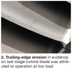

L-0 experience. A user discussing the design, operation, and maintenance of late- model L-0 buckets suggested that plant personnel track blade condition and failure probability over time to answer questions posed by corporate financial staff regarding operational risk. He reported finding indications on six L-0 blades extending from 0.25 to 0.33 in. from the trailing edge. One bucket was found with a 1.25-in crack starting in an area impacted by erosion.
An EPRI presentation complementing this experience urged station personnel to identify and track locations of erosion and to identify the source of the water. The speaker said erosion is heavily impacted by the angle of droplets hitting the bucket. He added that liquid droplet erosion can be found on leading and trailing edges on last-stage blades while operating in normal and off-design conditions (Fig 2).
The speaker encouraged the development online monitoring and inspection tools to identify damage on rotating equipment and to track the progression of LSB erosion. It was said that plants operating baseload can avoid erosion problems by using titanium L-0 titanium blades.

There was a great deal of discussion on valves throughout the meeting. In one exchange, the topic of fine-mesh stop-valve strainer baskets was brought before the group. Several users suggested their installation ahead of work planned on the steam path from the boiler outward. They will collect grinding/welding debris. But don’t forget to remove the baskets before the unit is returned to service: They can plug over time, collapse, and go through the machine.
Strainer basket rotation was cited as another problem. The group was reminded that there is a pin for correctly positioning the basket. However, several incidents of pins snapping off because of negligent work practices.

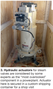

A user recommended conducting actuator outages every six years or at every other valve outage. At his plant, actuators are removed, crated, transported to the selected shop, overhauled, and returned. To dig deeper, read “How to Prevent an Actuator Failure from Tripping Your Plant,” CCJ No. 55 (4Q/2017), p 40. You can access this using the search function on the CCJ home page at www.ccj-online.com.
