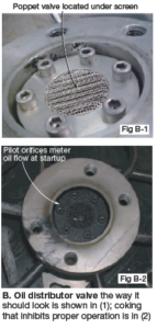

Typical of the problems encountered when running on liquid fuel is unequal distribution of the liquid fuel to each combustion can, which is caused either by plugging of fuel lines or nozzles, or by system leaks. Plugging or reduced flow to nozzles (Fig A) often is attributed to coking (Fig B). It occurs when fuel remaining in piping and other components on shutdown or transfer to gas is solidified by elevated temperatures in the turbine compartment.
![TTS-A TTS-A](https://www.ccj-online.com/wp-content/uploads/2021/10/TTS-A.png)
Check-valve malfunctions cited in Section 2 also contribute to improper fuel distribution. Plugging of the orifices in the liquid fuel nozzle by debris or particulates generally results from (1) inadequate fuel filtration, (2) poorly filtered purge air during gas operation, or (3) inadequate attention to keeping debris out of fuel and purge lines during assembly and disassembly.
Procedures and modifications that plant owner/operators can implement to help improve the reliability of dual-fuel systems are outlined below. As a first step, before making any changes, conduct a detailed audit of current O&M practices.

Several mods are available to reduce coking after unit shutdown. These include:
- Implement a high-pressure nitrogen purge of the liquid fuel lines after the machine shuts down to eliminate residual fuel as a source of coke formation. A simple purge system can be installed and operated manually, or it can be automated with some integration into the control system.
- Change controls logic to allow operation of the A/A compressor after unit shutdown to help cool the fuel-nozzle components and reduce the probability of coking. Air flow can continue for a fixed time period or until the nozzle cools to some predetermined temperature. Another way to reduce component temperature is to increase ventilation air flow in the turbine compartment. This helps prevent coking in the uppermost cans, where it is most likely to occur. Measurement of air and component surface temperatures in the compartment will reveal where inadequate cooling exists and where additional cooling air must be directed.
- Two more ideas to improve cooling: Some operators have had success keeping fuel lines cool by wrapping them with cooling water coils and then covering the coils with insulation. Others are testing recently introduced water-cooled check valves.
- Early identification of nozzle plugging. A modification to the liquid fuel system that promises early indication of nozzle plugging is active monitoring of distillate pressure to each combustion can. When coke or unfiltered debris plugs liquid nozzles, pressure increases in the fuel line. If a significant reduction in oil flow to a particular can occurs, it quickly creates a pressure imbalance between adjacent combustion chambers.
In some cases, the continuous flow of combustion products through the cross-fire tubes can occur. Once cross-firing begins, it often is too late to prevent burning or melting of the cross-fire tube and liner, as well as the deposition of molten metal on hot-gas-path components. Such an event can be identified by a high exhaust-temperature spread, but it can be detected faster by continuous monitoring of fuel pressures to each combustion chamber. By establishing a suitable threshold for the allowable pressure differential on adjacent cans, hardware damage can be prevented.
