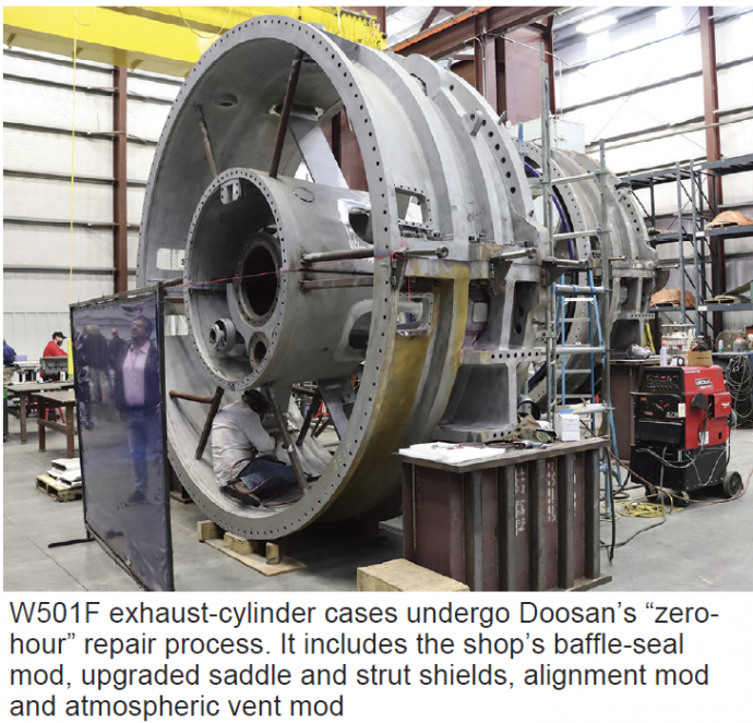

The exhaust cylinder was discussed next (photo). This section offers a valuable review of nomenclature before reviewing typical as-found damage—such as strut-cover damage and cracking, and outer diffuser cracking and distortion. Most of the material presented thereafter focused on the company’s “zero-hour” program for inspection, baffle seal and strut shield improvements, alignment and atmospheric-vent mods, and manifold repairs.
Think of the content in this portion of the program—24 detailed/heavily illustrated slides—as a checklist of things you should be aware of before digging into an exhaust system project. You’ll also learn what work can be done in the field and what requires a shop visit.
