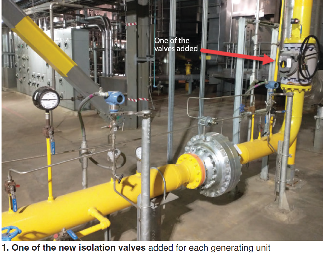

Challenge. CPV Valley Energy Center’s procedure for depressurization and purge of its fuel-gas system for inspection and maintenance required multiple movements of equipment (nitrogen trailers and hook-ups). Plant’s goal was having a procedure that didn’t require the movement of equipment and one conducive to faster purging.
Solution involved adding new valves to permit isolation of each section of the gas train (Fig 1) and a detailed procedure for depressurization and purge that stressed safety. The gas-line regulator manufacturer provided comprehensive instructions (more than a hundred steps) to achieve the plant’s goals.
The added isolation valves allowed depressurization and purging of sections of the gas line versus purging the entire line to both generating units each time repairs were needed. The regulator manufacturer provided instructions for staff to hold open the regulator, allowing the nitrogen purge to flow through the regulator at low pressure.
The procedure developed allowed one location for the nitrogen trailer to accommodate either a sectional or complete purge.
Results. The improvements made allow staff to depressurize and then purge the gas line in sections, or end-to-end, without moving equipment. Other benefits:
  • Reduced the time needed to achieve safe working conditions for gas-line work.
  • Reduced the amount of fuel vented when working on isolated parts of the line.
  • Ability to isolate one gas turbine at a time, potentially allowing the other unit to remain in service.

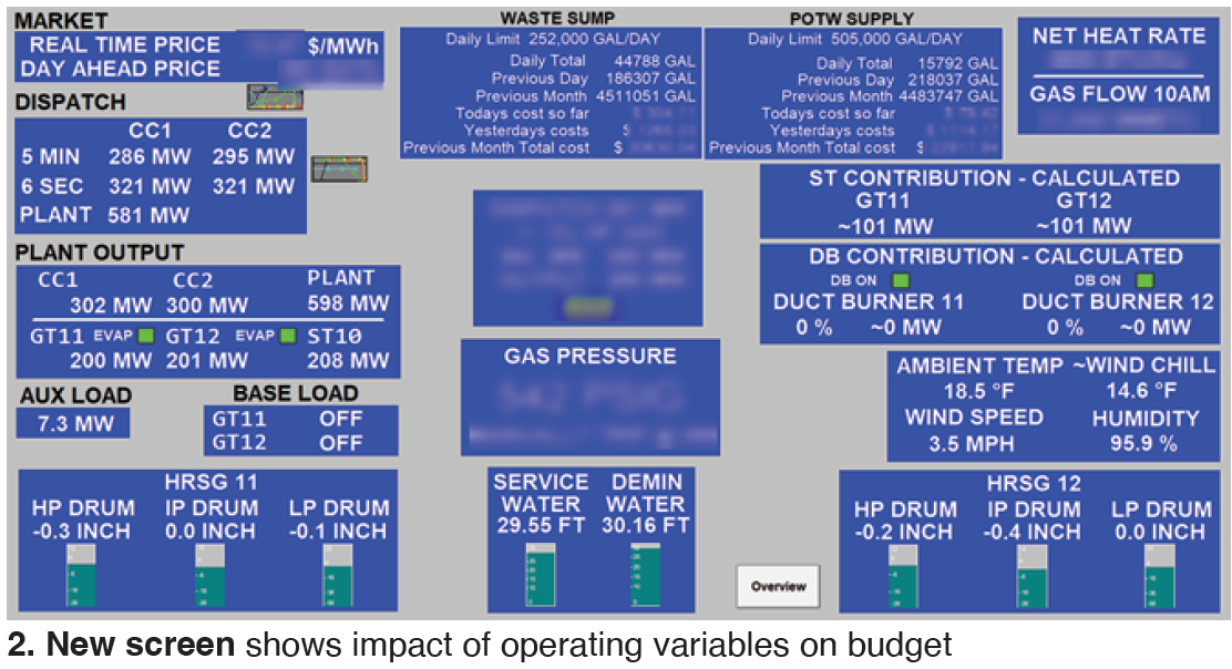

Challenge. While air-cooled condensers (ACC) contribute to a significant reduction in overall water use at combined-cycle facilities, CPV Valley was struggling with high usage and discharge rates. This created issues with overall water-management expenses—including higher gray-water intake and discharge costs, higher chemical usage, heat losses in the HRSGs (contributing to higher heat rates), and the need for increased operator involvement in maintaining plant chemistry and tank levels.
Solution. Through a collaborative effort, the CPV Valley team developed the following key action items:
  • Conduct a comprehensive review of chemistry logs with third-party consultant HDR Engineering. Outcome: The cycle-chemistry control strategy (intermittent and continuous blowdown rates) was adjusted to optimize system performance while dramatically reducing blowdown and quench-water costs.
  • Initiate monthly chemistry review meetings with the O&M staff and HDR Engineering.
  • Update the plant’s Cycle Chemistry Manual; train the O&M team on the changes.
  • Conduct a plant-wide thermographic survey to find leaking drain valves. Outcome: More than 100 valves in the steam cycle damaged or worn out during commissioning required replacement or repair.
  • Review and optimize water-treatment-system self-cleaning and backwash rates to reduce waste.
  • Update operator process screens to show daily intake and discharge rates to raise awareness of their impacts on the plant budget (Fig 2).
  • Perform a recapture pilot to collect valuable process and chemistry data for possible capital system upgrades in the future.
Key results of implementing the solutions above included the following:
  • Reductions of from 30% to 50% in monthly water use, discharge rates, and chemical use.
