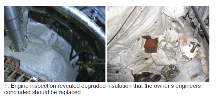

It’s possible to learn a great deal by simply listening. Consider your turbine’s insulation system—an afterthought at many plants until the package temperature exceeds best practice, someone inadvertently comes in contact with very hot metal, etc.
      • How would you inspect your unit’s insulation to determine if it is beyond its useful life and replacement with an upgraded system would improve both performance and safety?
      • What are the key steps in the replacement process?
      • How long does the project take from inspection to determine current condition to restart after installation?

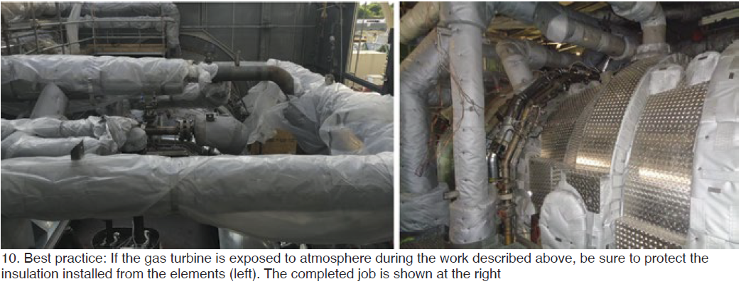

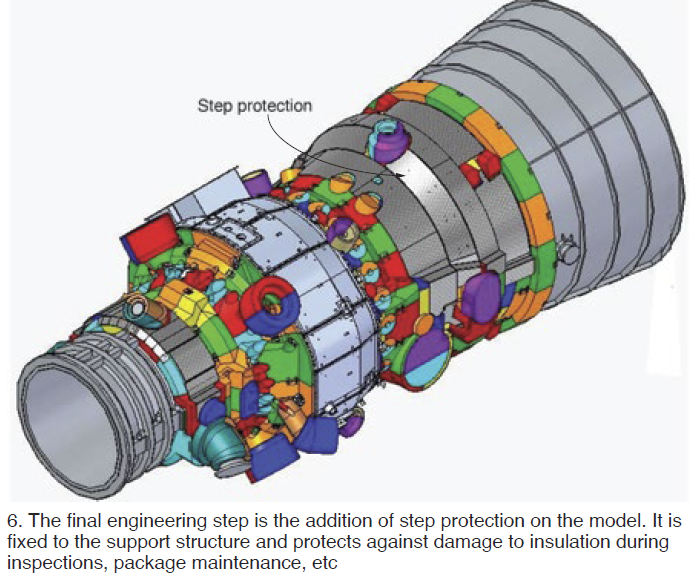

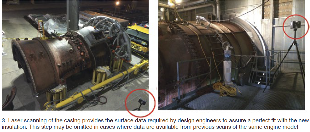

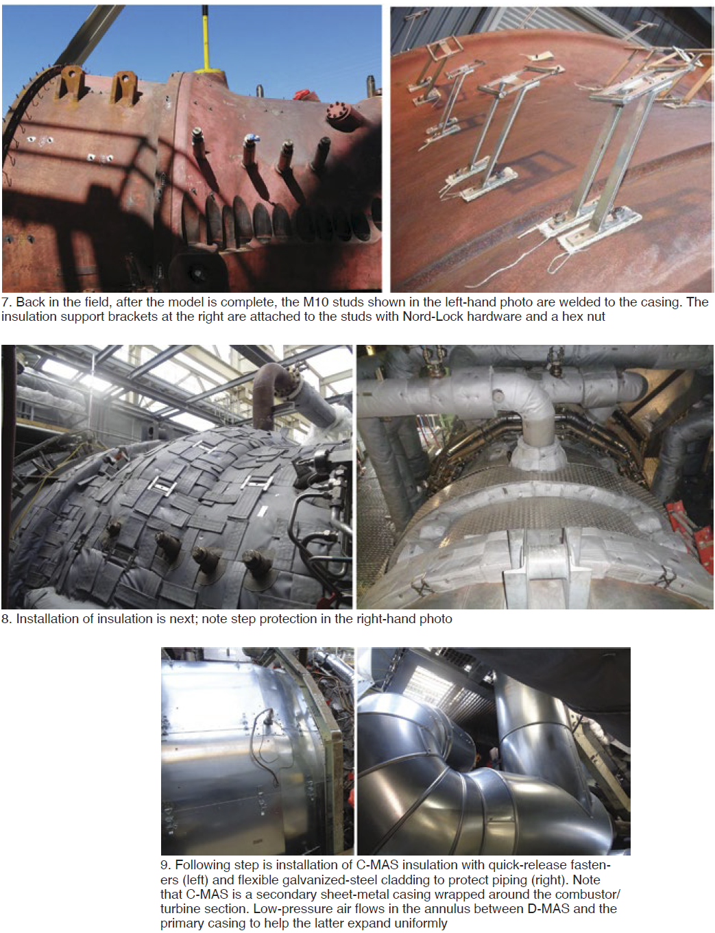

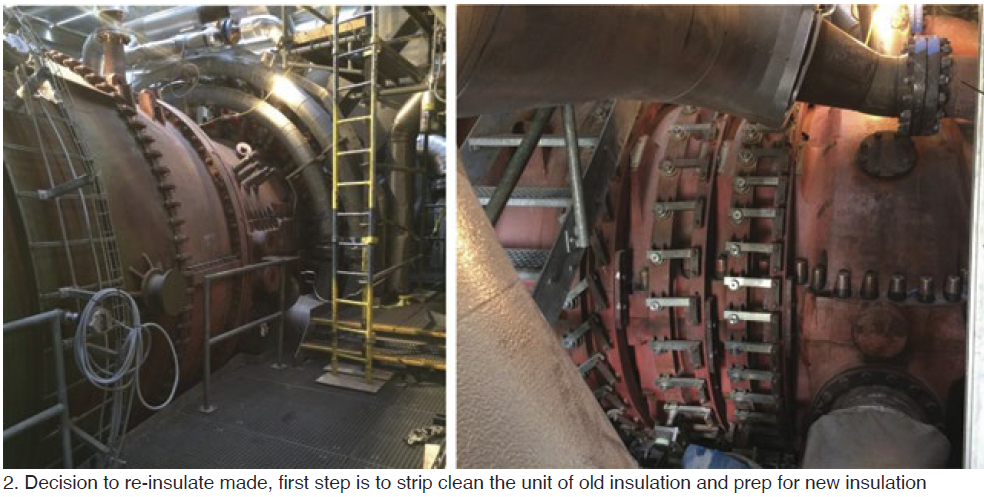

The photos below walk you through the re-insulation of a GT24, a process similar for all frames. Spending a few minutes looking at the images will likely raise questions in your mind about things you want to know more about to make better decisions for your plant in the future. Pierre Ansmann will be presenting for Arnold Group at the AOG conference. Listen to him in the 7:30 to 8 a.m. time slot on Thursday, March 4.
Replacing turbine insulation—a 10-step process
