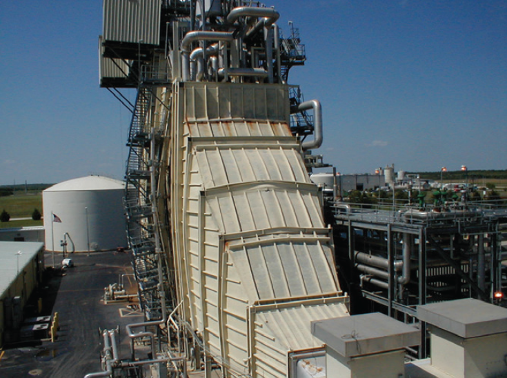

An MS6001B in Florida experienced a significant failure in 1994 when its stop-ratio valve (SRV) servo failed. On startup, the unit cranked and fired successfully; however, the valve continued to open. The failure was caused by the servo sticking at a slightly open position, allowing the SRV to continue opening at a slow rate.
The SRV excess-fuel trip was based on the valve’s position, typically 33.3%. The excess-fuel trip was inhibited by L28FDY, flame plus one second.
When flame was established, plus one second, the trip was inhibited but the SRV continued to open. Exhaust temperature increased but not to the over-temperature set point. The fuel/air mixture was high enough to increase the exhaust temperature, but the limited oxygen at crank speed allowed a very rich fuel/air mixture to continue through the turbine until it reached the HRSG inlet duct. The additional oxygen in the HRSG triggered an explosion, damaging the boiler (photo).
The modification suggested to prevent a failure of this type in the future was to add a 60-sec timer to the trip. The failure and modification were described in Mark V Newsletter, No. 6, Feb 13, 1995.

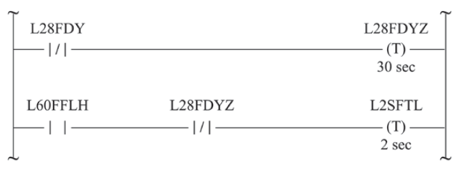

LIQUID FUEL. The excess-liquid-fuel trip constant LK60FFLH should be set to 5% of the 100% FSR (fuel stroke reference) fuel flow, which is the approximate flow at a warmup condition of 16% FSR and 30% speed. The excess-fuel trip rung should be modified to inhibit the trip 30 seconds after flame rather than at the completion of warmup as shown in the diagram below.
Actual operating conditions on liquid fuel, such as startup FSR values and firing speed, may vary from unit to unit. This may necessitate slightly different excess-liquid-fuel trip settings. The unit should be started and the fuel flow monitored to determine the actual flow from firing to the completion of the 30-sec L28FDYZ timer.
The excess-fuel constant should maintain a minimum 1% margin to the observed flow. Fuel flow also should be monitored on a hot start since the unit acceleration and fuel flow will be higher than on a cold start. If the observed flow exceeds the cold-start excess flow, the L28FDYZ timer should be reduced to the point at which the hot-start flow equals the excess-fuel constant minus 1%.

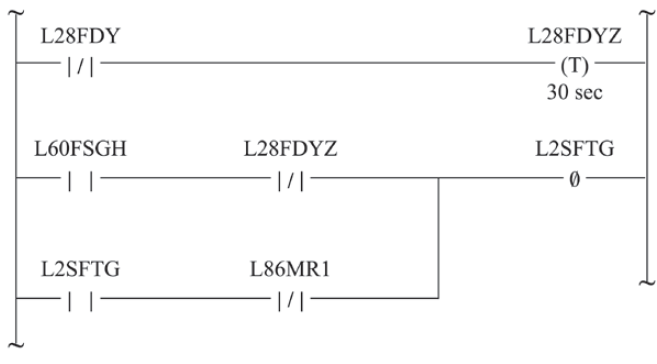

GAS FUEL. The excess-gas-fuel trip constant LK60FFGH should be set to 10%, which is the expected ratio-valve opening with a margin of 5%. The excess-fuel-trip rung should be modified to inhibit the trip 30 seconds after flame rather than at flame (diagram below).
Actual operating conditions on gas fuel, such as startup FSR values and line pressure, will vary from unit to unit. This may necessitate slightly different excess-gas-fuel trip settings. The unit should be started and the position of the ratio valve monitored to determine the actual movement during firing. This value can then be used as the excess-fuel trip with a 5% margin.
The Mark V Software Note added the timer and reduced the SRV position trip from 33% to 10%.

Users of Mark IV and Mark V controls installed prior to 2000 should check to see what protection is installed for excess gas-fuel flow. The trip logic is L2SFTG, Startup Gas Fuel Flow Excessive. The control constant for the valve position is LK60FSGH, Startup Fuel Stroke Reference High Alarm Setpoint.
The easiest change, if the position constant, LK60FSGH, is higher than 10%, would be to reset it to 10%. This will not avoid all potential failure modes, but it is better than doing nothing.
Addition of the 60-sec time delay as shown in Software Note 98 would be the second most effective protection.
