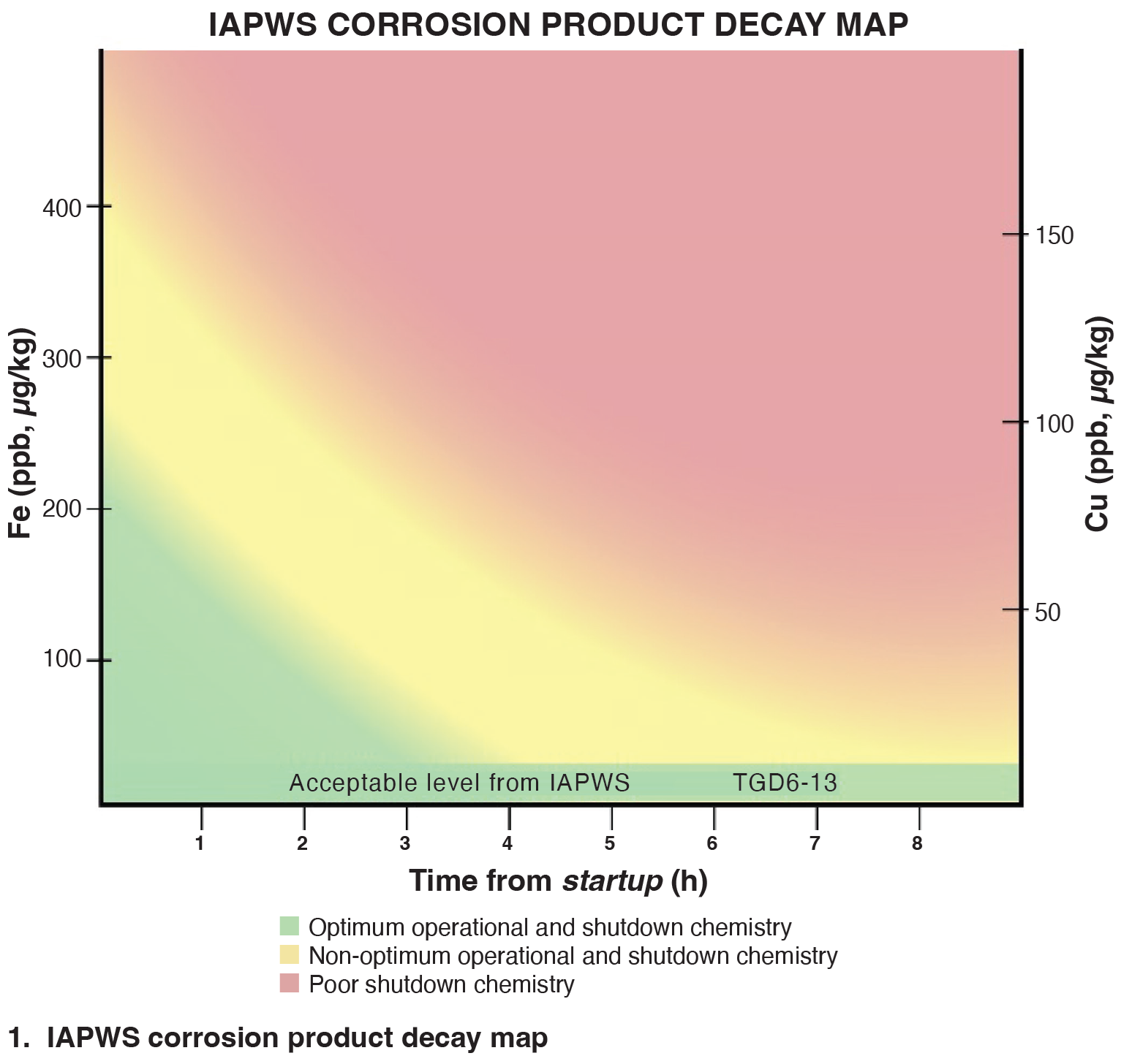

A major contribution of this White Paper is the IAPWS Corrosion Product Decay Map (Fig 1), which enables operators to track corrosion product levels over time and evaluate the effectiveness of their shutdown and startup chemistry. As the White Paper states, “the map allows iron and copper corrosion product decay profiles to be overlaid.”
The map categorizes plant performance into optimum (green), moderate (yellow), and poor (red) areas. Plants that fall within the green area exhibit low corrosion product transport, indicating well-managed chemistry. In contrast, plants in the red zone experience excessive transport, suggesting inadequate shutdown preservation or suboptimal operational chemistry.

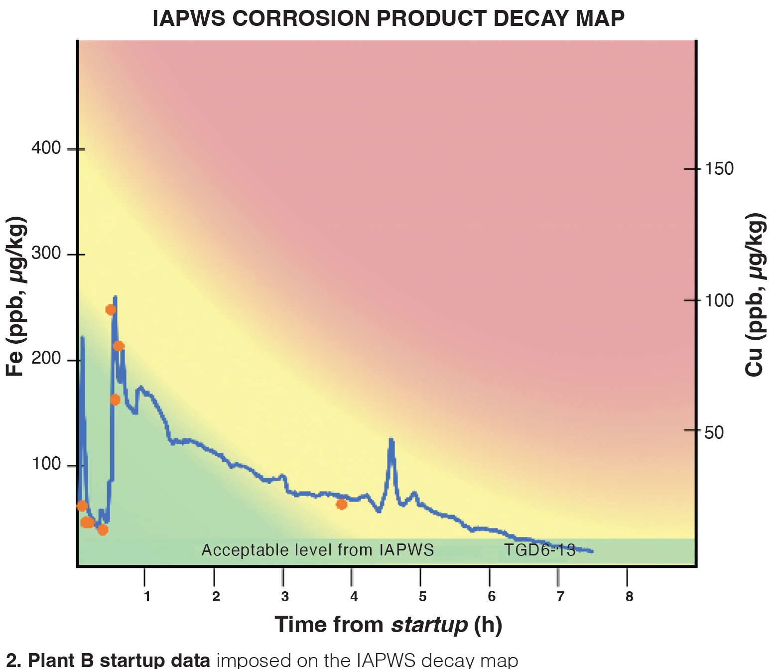

The document includes case studies that demonstrate the impact of corrosion monitoring and control strategies. In Plant A, where proper shutdown chemistry was applied, corrosion product transport remained within the green area of the IAPWS Decay Map, indicating effective preservation. Conversely, Plant B, which lacked shutdown preservation, exhibited prolonged high iron transport, placing it in the yellow zone (Fig 2). Plant C, a mixed-metallurgy system with an FFS applied, showed reduced corrosion product transport, though further optimization was necessary. Plant D, which experienced daily load cycling, displayed significant iron and copper transport with each load increase, underscoring the need for operational improvements.

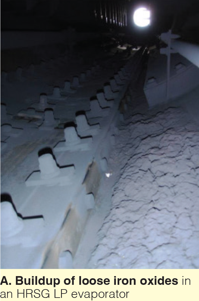

Case 1
Two-phase flow accelerated corrosion occurred through incorrect chemical treatment and failure to follow IAPWS TGDs, resulting in loose iron oxides (Fig A). No corrosion product sampling for total iron or particulates was in place. Full replacement of the LP evaporator was required after only ten years of operation.

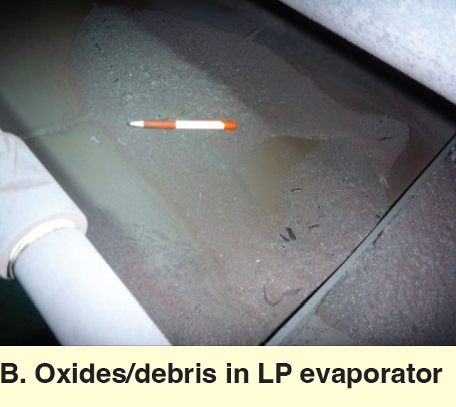

Case 2
Loose oxides/debris were found in this HRSG LP evaporator during early operation (Fig B). Poor layup and storage practices contributed, and there was no corrosion product sample practice in place for total iron or particulates. Practices have now been corrected.
