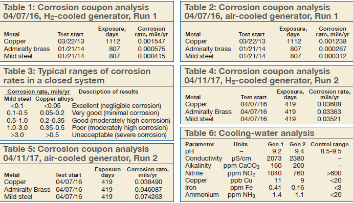

Perez Ghisays and his staff decided that fouling and corrosion should be monitored to gather solid evidence of chemical effectiveness. Corrosion coupons are used for this purpose and are evaluated periodically. Results from the first round of tests are presented in Tables 1 and 2. They compared favorably with corrosion data in Table 3 for mild-steel and copper alloys available in the literature and considered “excellent” (negligible corrosion).
Corrosion data from the second round of tests (Tables 4 and 5) were similar to the first-round results.
Table 6 shows data collected were within the “allowed” range based on industry resources. Note: The nitrite residual guarantees system-wide corrosion protection.

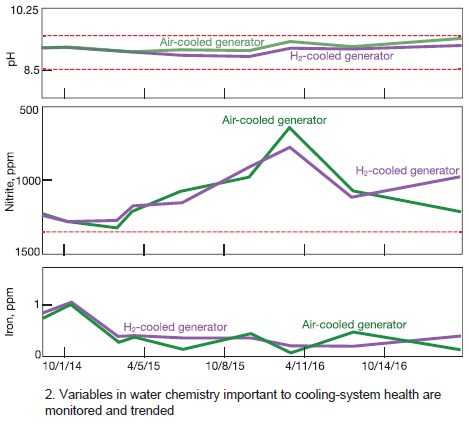

Fig 2 tracks important operating parameters—pH, nitrite, and iron—over a two-year period.
